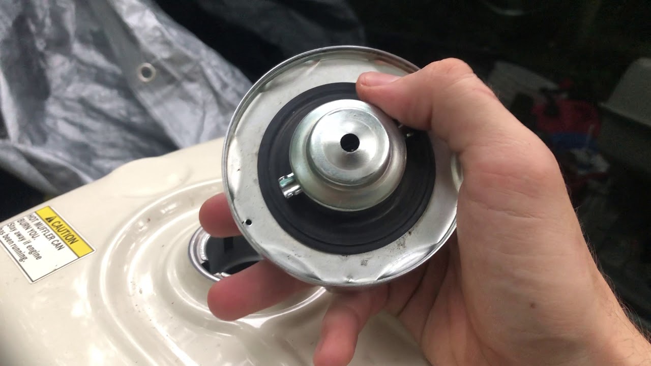

I’m working on modifying my pickup truck power wash setup. My buddy gave me a 6 gallon marine gas tank and I’m curious if I can rig it to my pressure washer’s Honda engine to achieve extended run gasoline supply. I wanted to ask here before I did any damage to my machine. I’m thinking of drilling a hole in my gas tank cap and inserting a brass barb with a gasket. This would achieve an air tight gas tank with an inlet. I’d attach the inlet to the supply line for the marine gas tank, which includes a primer bulb. I’ve seen people run these types of gas tanks to Honda generators, but haven’t seen it done on a Honda pressure washer. Can’t think there’d be a difference. I’d assume that if both the gasoline chambers are air tight, this would allow for the gasoline to be drawn through the siphon up into the engine. Thus, the marine gas tank wouldn’t need to be gravity fed, and could be positioned below the pressure washer rather than above.
Would this work? Worst case scenario, I ruin my gas tank cap and buy another one.

Aren’t those caps vented? I mean, air has to replace the gas somehow as it’s used up.

@infinity is right. Long story short, you won’t get enough vacuum to pull the gas out of that extra tank. If you wanted to do what you’re thinking, you’ll need to bypass the metal tank altogether and tie into the fuel line going to the carb. Then you can either install a pulse pump or a 12v fuel pump (battery required) to pull from the 6 gallon tank. You might be able to raise the 6 gallon tank to get a gravity siphon but it could starve sometimes. Cutting out that primer bulb is a necessity either way

Yes, the cap is vented. Didn’t think this through. You are right that air would need to enter into the chamber.
