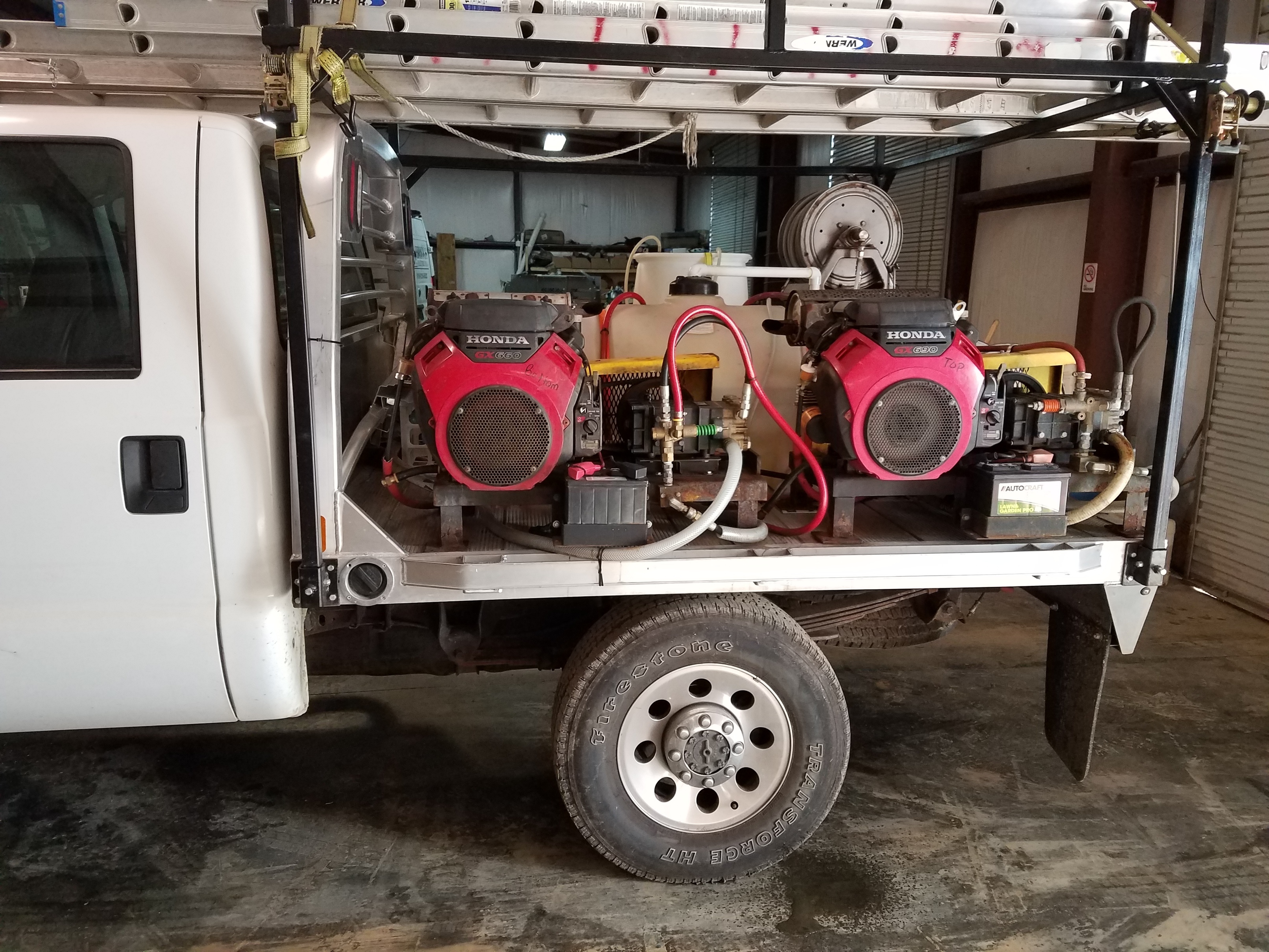

I replaced these. They still have life in them but I got a good deal on two new machines.
Not to derail the conversation, but that’s an interesting setup with the unloaders. What’s the purpose of the jumper hose between the pump and unloader? Just to take up a smaller area?
Never mount the unloader directly to the pump. Vibrations destroy the pump and cause leaks. I use unloader blocks with a jumper hose.
Gotcha. Good to know.
I wish you would start a “how, exactly, to set up your rig” class or something…for real! Would it be possible to get more photos of your rig?
That would be awesome. I’m sure there are a dozen or more issues with my setup.
Btw, @Innocentbystander, what fittings did you use on the pump inlets? Looks like you have 1" or 1.25" hose going straight to the pump. Pretty hard to find a brass or stainless 1/2" mpt to 1" barb fitting
Use brass on the pump. Absorbs vibration better than stainless. Udor has one inch inlets.
