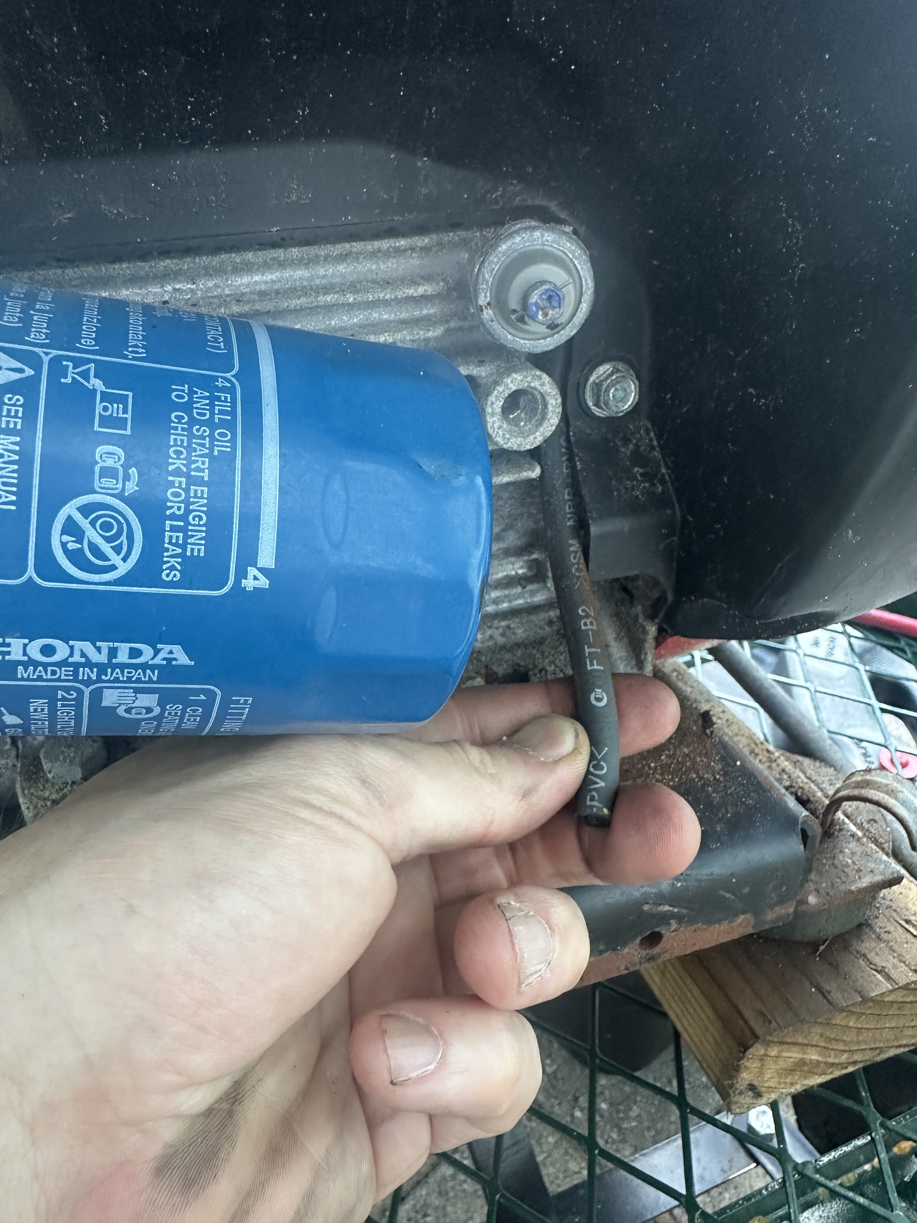

I purchased a second hand 8 gpm unit that has 200 hours on the gx690 meter. Guy said it worked just fine but couldn’t start it when I drove over 2 hours to buy it. Anyways I bought it and am taking everything off the skid to sand the skid down, tune up the gx690 and replace the pumps seals.
My question is, what in the heck is this line??? It’s not my fuel line because I already have two of those going to my fuel tank. Any advice is welcomed!

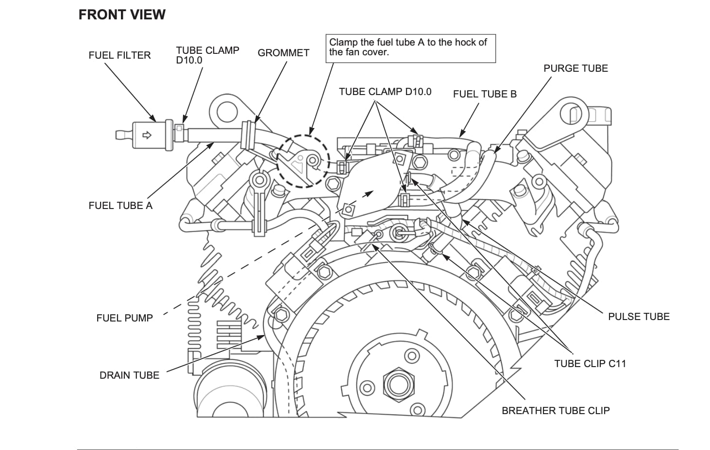

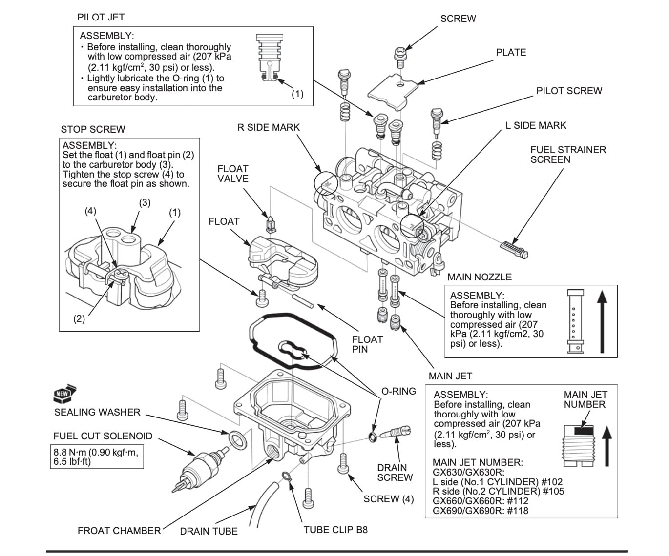

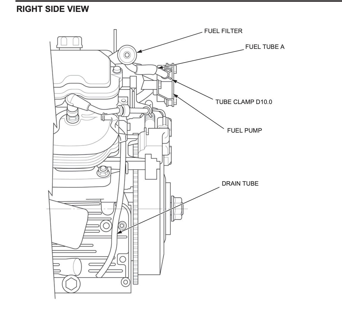

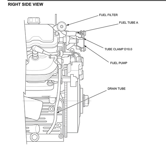

Carb drain tube. Turn the flathead screw on the opposite side of the carb and fuel will flow freely out of it (if the carb is good that is)
