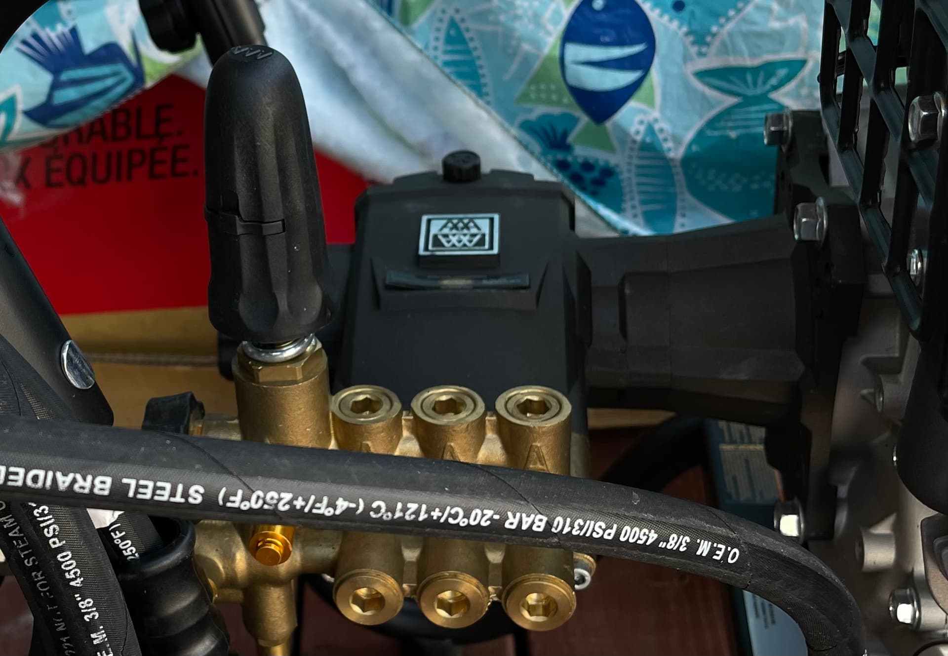

Hey, does anyones pump get super hot? Like to the point where if you touch it for longer than 1 second you’ll burn yourself.
I have a 4gpm 4400 psi cold water direct drive, was doing work on my own property today and noticed the pump was very very hot. Is that normal? If not, how can I fix this?
What’s your bypass/buffer situation look like? How long was it running without pulling the trigger? Probably 2 of the possibilities that I can think of.
When you’re not holding the trigger on a direct drive machine there is no new water passing through the pump. After about 45 seconds that little bit of water in the pump gets too hot to efficiently cool the pump. If you don’t let the water cycle through and the pump gets too hot, you risk damaging your pump. Its likely the damage has already been done if that’s the case but your pump shouldn’t be too hot to touch.
Don’t have either of those. Just starting out so got what I could afford, it was running continuously until I went to turn it off. Even the water that came out after unscrewing the garden hose was very hot because of the pump.
Hot water recirculating in your pump when your off the trigger most likely….
Could that cause damage to the pump?
Sure, burn it up. I’d take the recirculating line off at the bottom and let water run on the ground. You will then be at least introducing fresh cool water to the pump when off the trigger. Or get a buffer tank.
