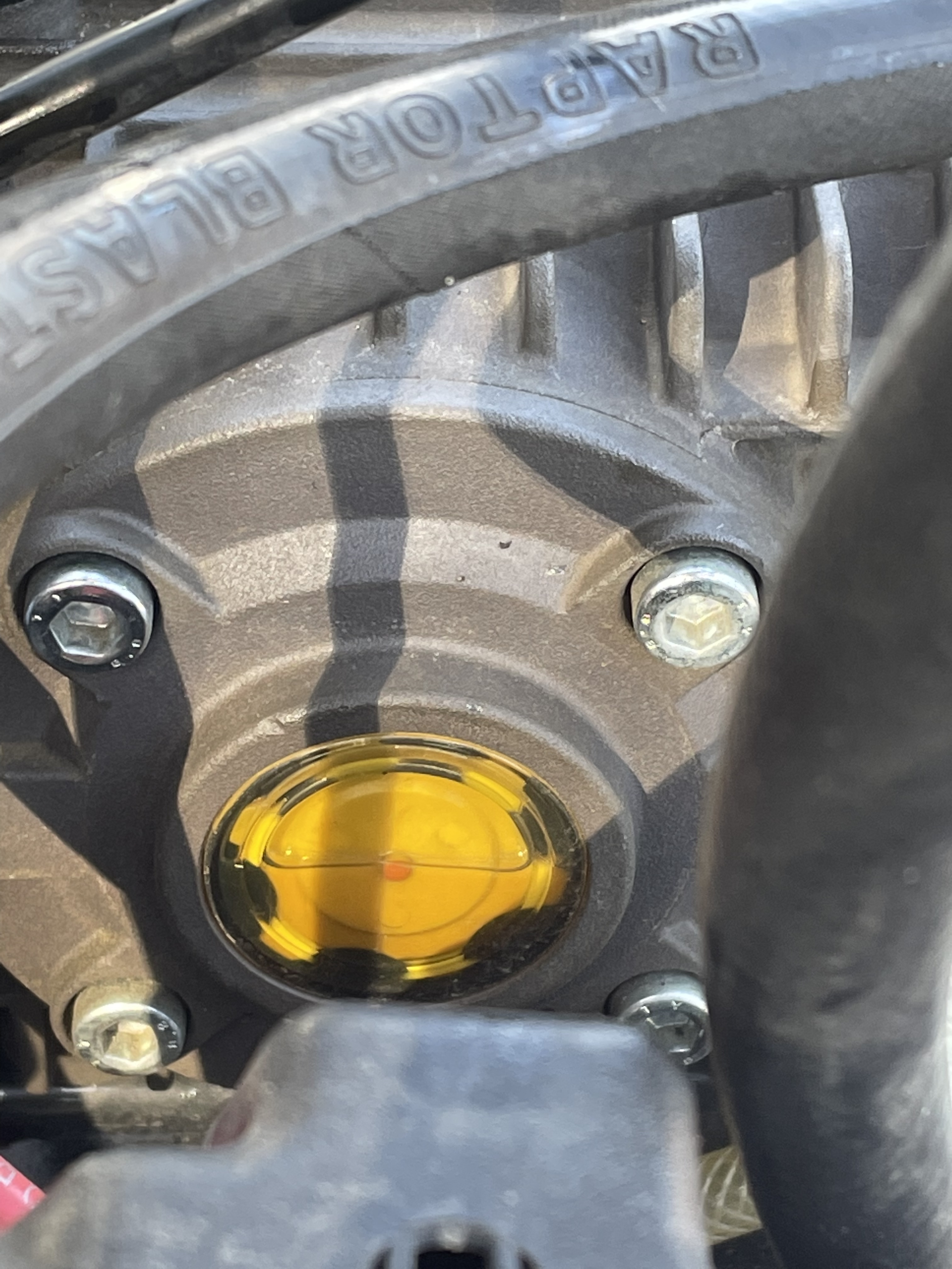

Like this? Took a full 32oz bottle and i was below the dot so i added more. I think the rig was pretty level. Hope I didn’t overfill. Drainline they put on is too dang short to drain without making a mess.
Just like that. That’s perfect.

Oh no! I have 15w40 rotella! And its over the red dot! Oh please, oh please help me! This pump might not make it another 1500 hrs!
I forgot the pic
Way above the red dot.
That oil is nearing change intervals and has no obvious contamination
Send it!
You’re proud that you’re running too much of the wrong oil? Look, you can do whatever you please. No one here is going to stop you. That doesn’t mean you should encourage others to do things that may jeopardize their ability to earn a living.
It’s an oil bath. There isn’t any contamination regardless of what oil you use. But, your detergent oil is not made for what you are using it for. Fortunately for you you change it so often it will probably be ok. You really need to stop with the bad advice though so as not to screw with the new guys.
