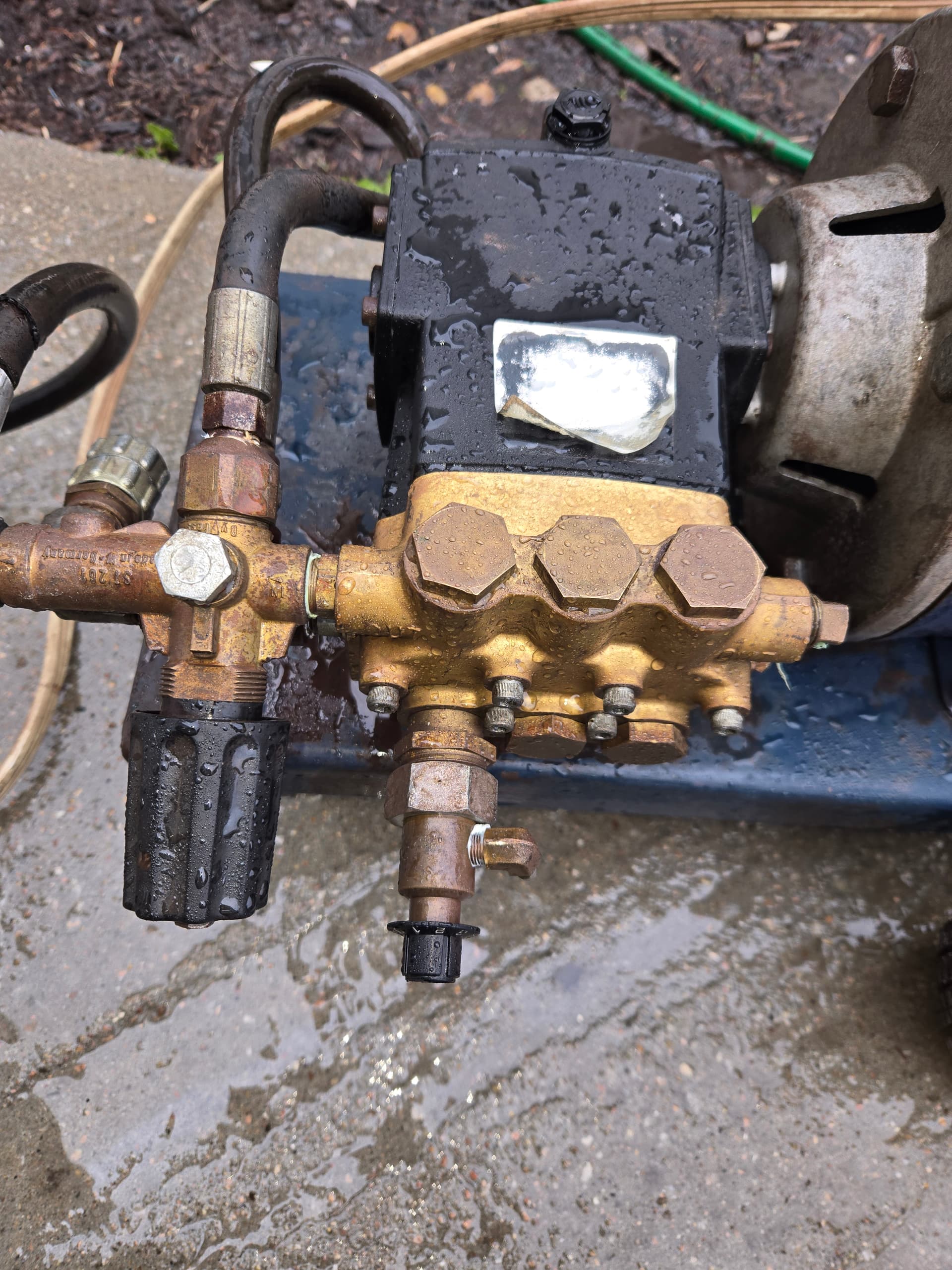

Needing help trying to identify what pump i have. Got it at a auction. Works good just leaks. The id tag on the pump was worn off.

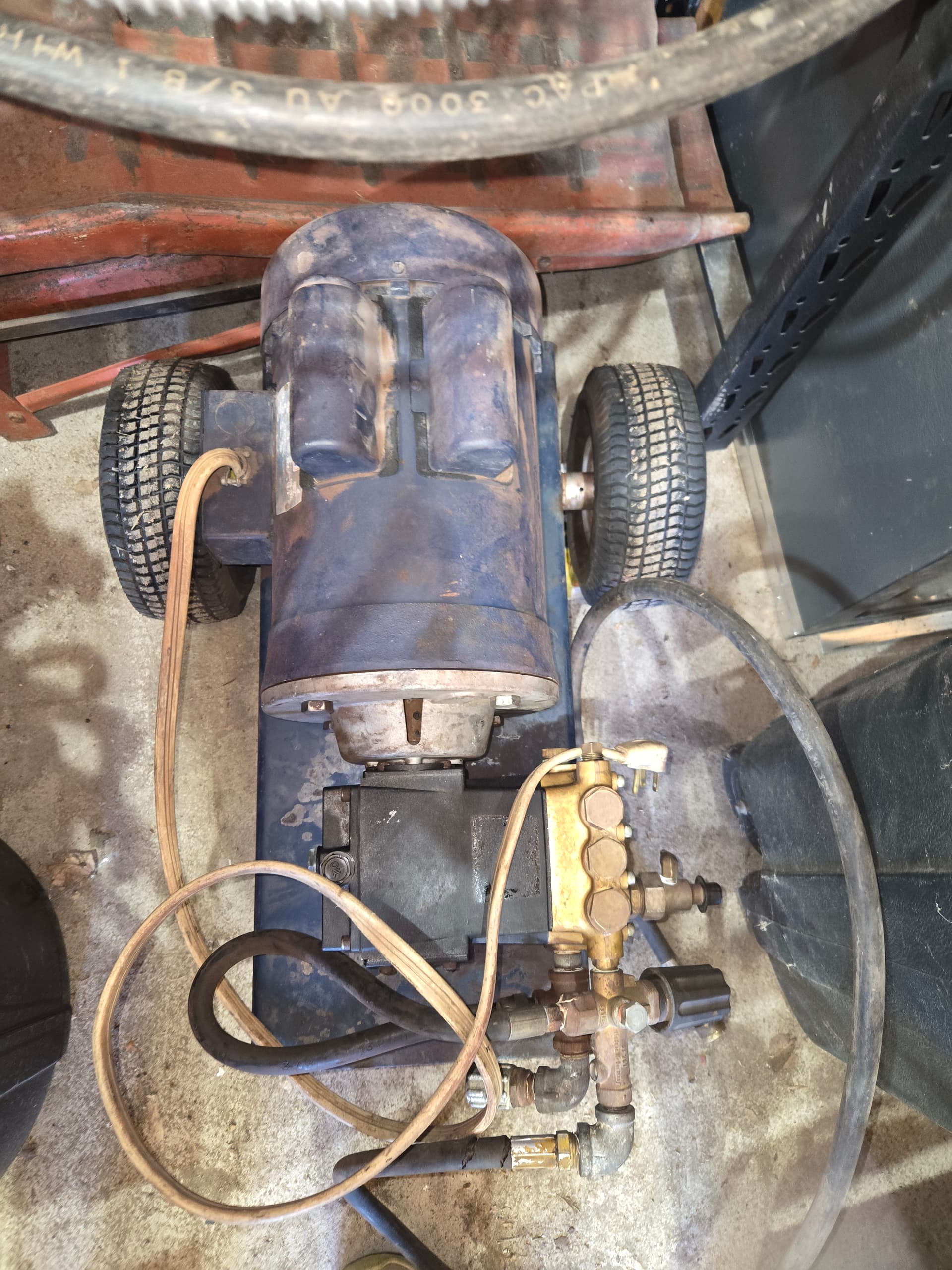

At first glance it screamed “AAA”… but after looking at it some more, I’m not sure thats right. I feel like their valve plugs usually have indentation for hex keys and the “made in Germany” unloader is making me think Karcher… got any more pics of the whole machine? That drive might give more clues.
appears to be a hawk or legacy pump version for electric motor
What exactly leaks on it? 2200 series are duplex pumps and 2400 series have huge 3/4" inlets. So that makes it a 2300 series Powerline Plus, final answer!
Yes it does look like that leaks from the bottom off the brass head. Can get a pic of leak.if need be.
It gets good pressure still. Would like to rebuild if i can

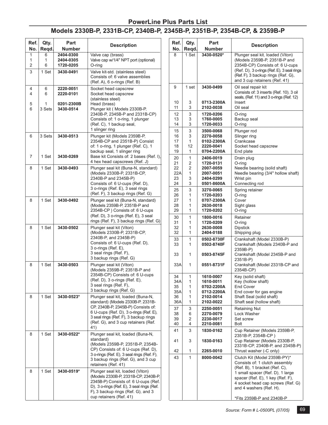

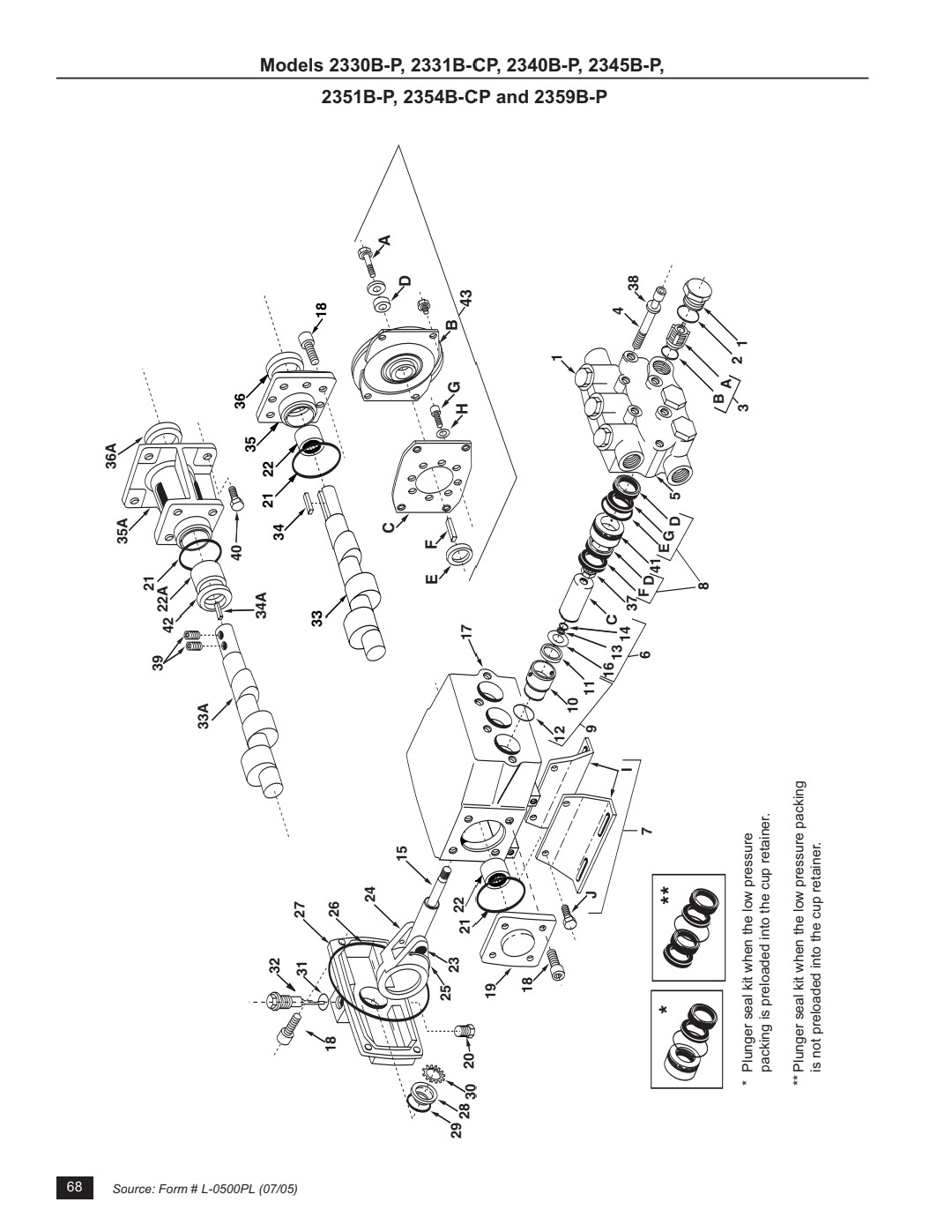

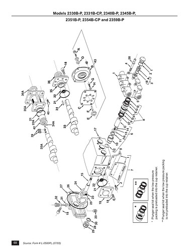

I don’t see any seal kits available online. They’ll have to be special ordered through one of their distributors. I’d use kleen-ritecorp.com ! The seal kit part number is 3430-0520
