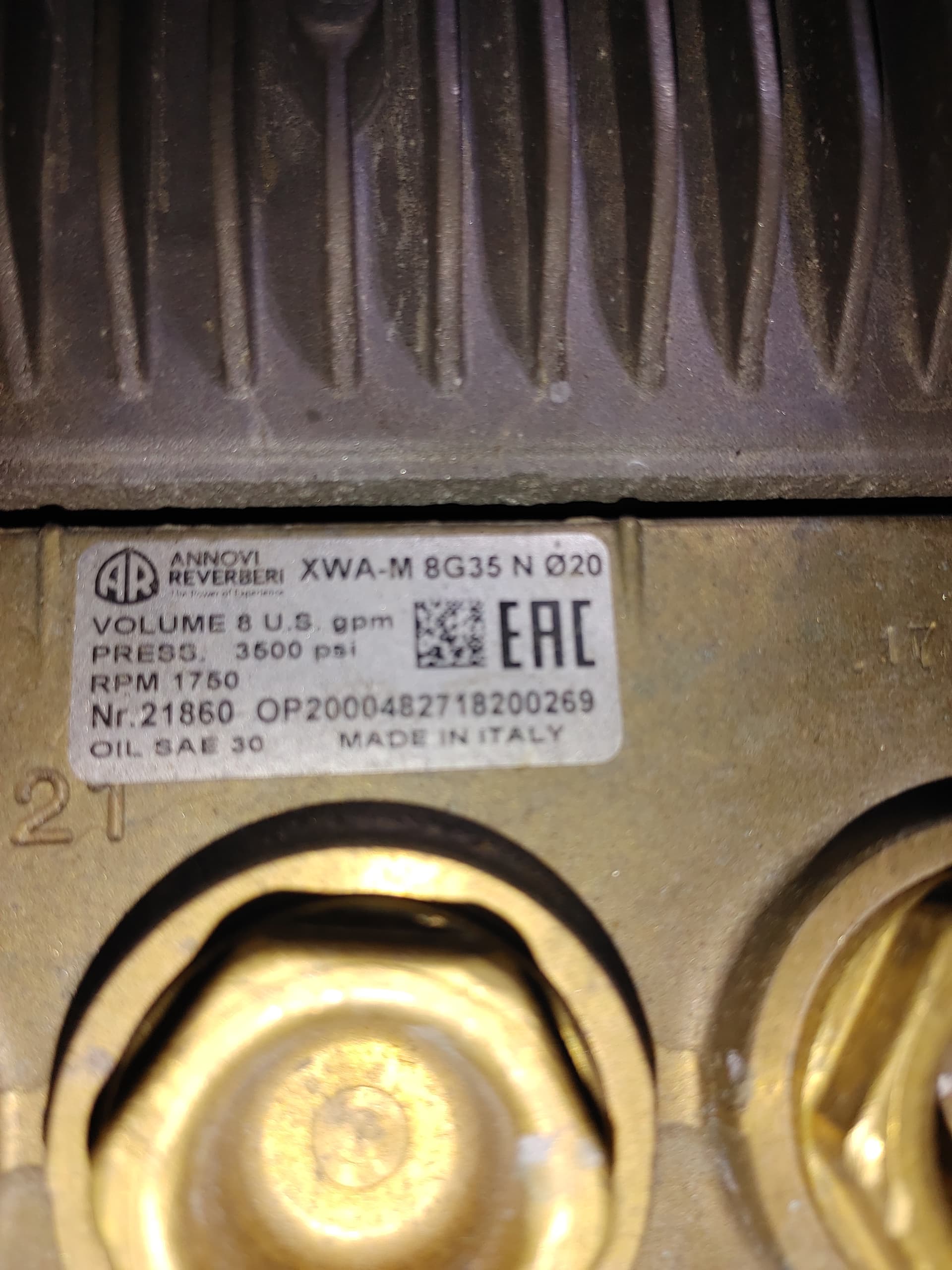

What pump do you have?
If it was for a very short time, the pump is probably okay. Could be a number of things but my guess is you have an air pocket between the buffer and pump. If not that, could be a stuck check valve(s) or you chewed up the seals or even possibly cracked a plunger(s). All are easy fixes once you have the right parts and tools.
Never bought from this site before but they show pretty much every serviceable part for that pump.

If i killed the pump it’s just bolts to remove, change pump and rebolt?
Looks like youtube and i have a date.
The pump only dies when your crank is poking out the side of the case. That rarely happens. The manifold is the brass portion held on by eight hex head bolts and can be fully rebuilt unless the brass has cavitated to the point where the new seals won’t form a proper seal around the plunger (piston). In that case you have two options: buy a new manifold and slap it on or just bite the bullet and get a new pump. Typically, on those cheaper pumps (quality, not price) it’s just not worth replacing the manifold. At that point just buy a new pump and be done with it.
Really not even necessary to replace seals. Just do one cylinder at a time and pay close attention to the orientation of each seal as you remove it and put the new ones in in reverse order but exactly the same orientation. If you get into and need help just PM me and I’ll shoot you my phone number.
