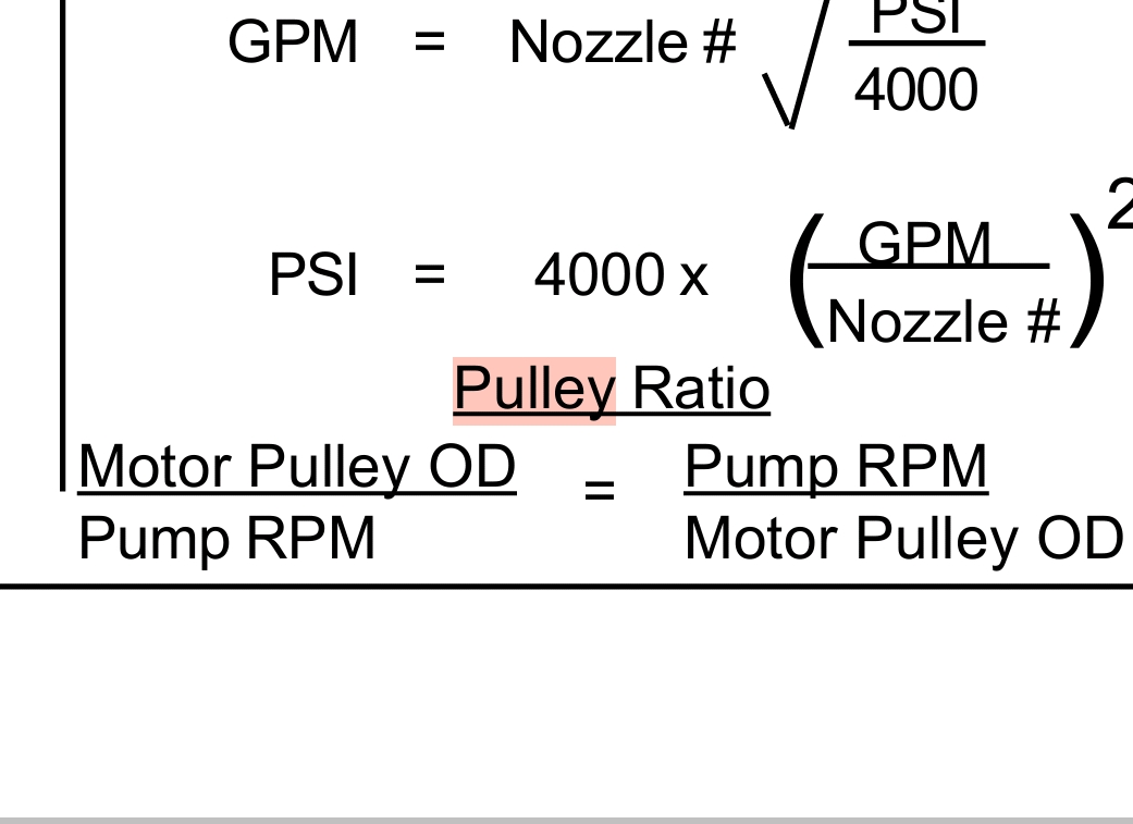

4.15 in engine side pulley, 8.75in pump side, something like that
