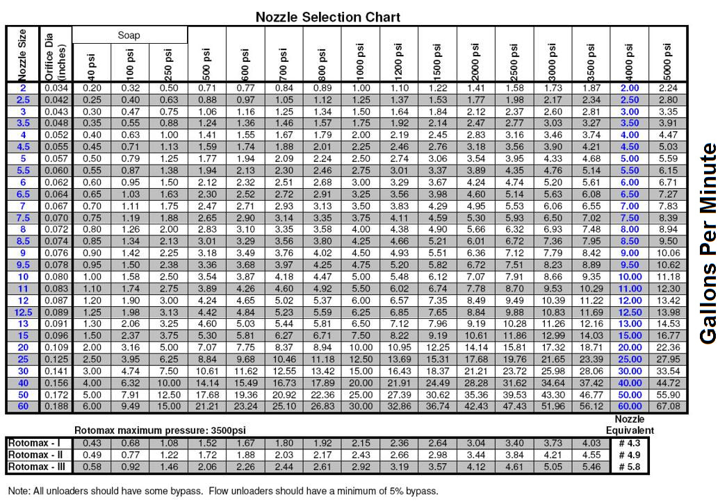

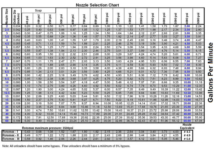

You should not be “setting” pressure on your pressure washer. The pressure needs to be determined by the nozzle used. For edges of concrete, I use a 2505 nozzle with my 4 gpm machine. That’s theoretically ~2500 psi. With 4 GPM coming out, you’re going to be blowing stuff around no matter what. I use a 0510 nozzle for rinsing (~650 psi) and even that will blow crap everywhere if you’re not careful. The best you can do is be steady with your aim and carefully cut in edges.
Side note, I don’t use any of the nozzles that came with the pressure washer. I only use 0510 for rinsing, 4008 for wood or new concrete, 2505 for anything hard, and a turbo for that stubborn stuff.
