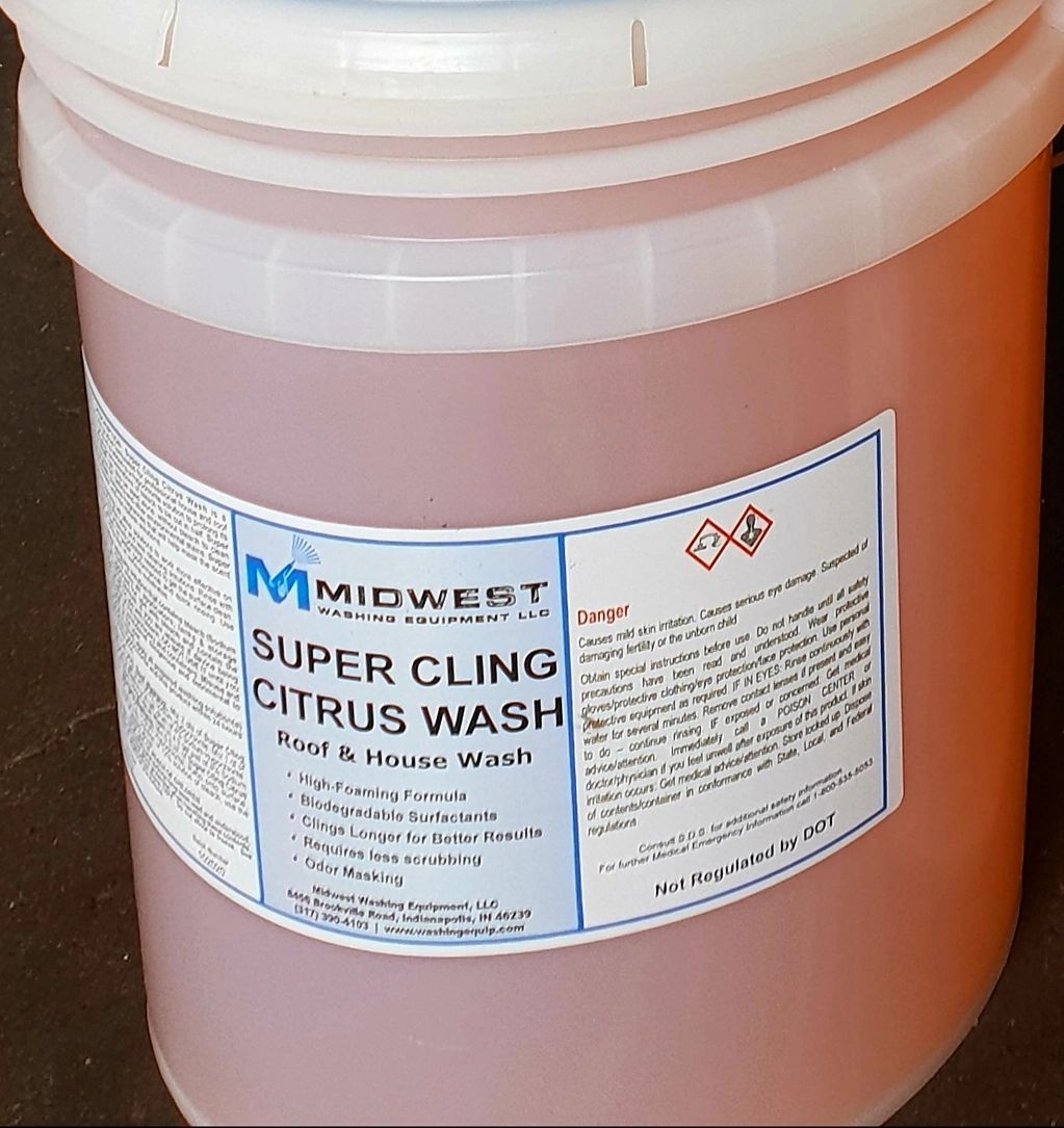

This is what I’ve got a good amount of aside from the 10 gallons I just picked up of elemonator on the way up. I have not had luck finding anyone willing to ship anything bleach stable so after my 10 gals of elemonator are done it’s back to the drawing board. Used this stuff all last year and it definitely thickens up the SH and makes it gross after a day or two.
