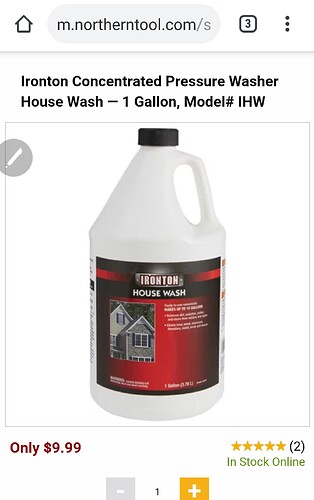

Has anyone tried this for oxidation? It makes a claim to remove it.
