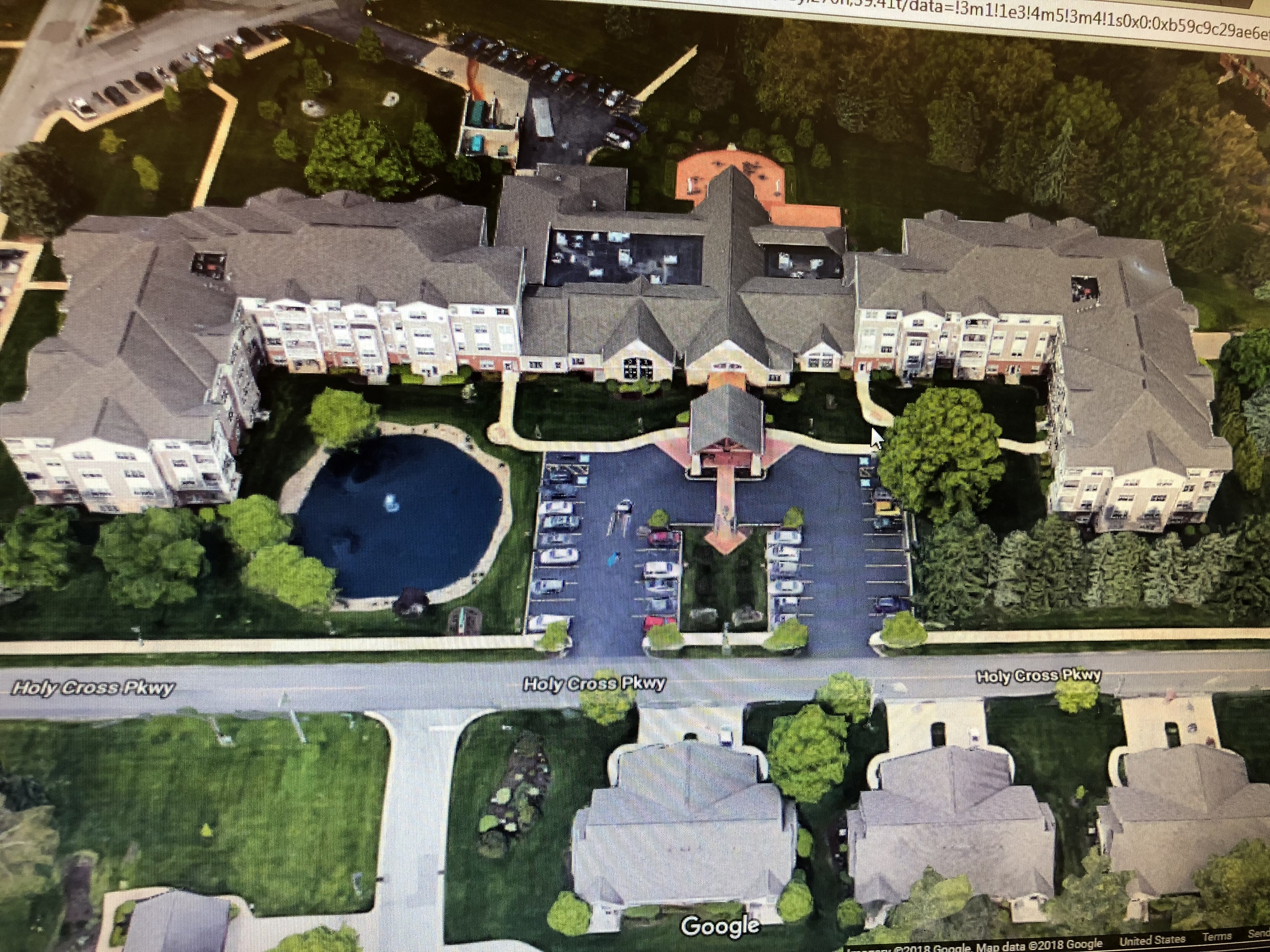

I have not posted in a while, but I am just double checking pricing for a friend who asked me to help on this apartment building. He bid this place at $5100 plus materials totaling around $8000. I feel he should have bid $13,500 for the total building. What do you all feel on the price?
Are you doing any concrete cleaning or just siding
currently no flat work. Siding, brick, and wood…
Really hard to say without knowing linear foot or the condition of everything. Too little information here.
Around 2000 linear feet. i have not actually been to the property, but when i price it at what i charge based on how he wrote it up we have a large gap in what we should charge.
3-4 story?
4 stories, and I’m sorry the actual linear foot is 2500

I’ve estimated 2 apartment complexes this summer that were 3 story. I try to get $1 per line foot per story. Never been asked to do a 4 story so I’m likely no help. $4 a line door puts you at $10,000
But at 4 stories you’ll likely need a lift ($600 week)
Off the cuff I would be at 12k and would be ok if they turned it down for the pain of a lift use.

Also, If the height is 50 feet. Get a 65 foot lift. $1100 a week for the big one. You’ll need the extra 15 feet more than once. Belee dat!
Best bet on a lift is to price it at the highest number you get after calling 4-5 rental places. Don’t forget delivery.

As far as $13,500, I feel that’s probably a tad low. How many units in total for the entire building?
That’s 8 small apartment buildings there, but access and that pond is a nightmare. I’d be closer to $15-$16k and hope I don’t win it.

The rate works great for 1-2 story… you get into 3-4 and I think adding 20-30% per story per foot would be acceptable.
Complex I did last year took 35 man hours and was 9k
