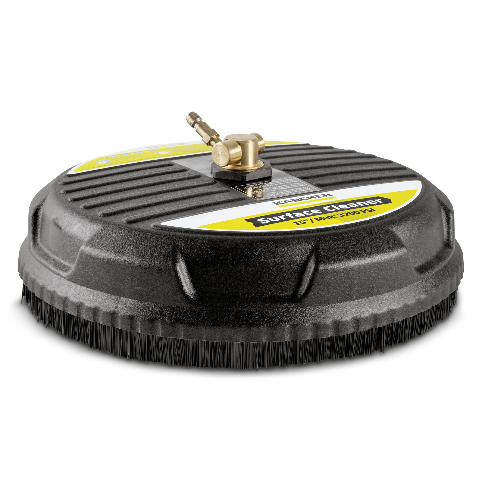

Ok, so you’re using one of these…
Please be careful with that, it’ll eat concrete right up. Don’t show up to a customer’s house with it.

Something like that yes a 150 dollar one from lowes. What would you reccomend?
Actually, you can change the nozzles on the karcher and BE 15in surface cleaners. I’d definitely recommend a more professional one if you’re doing this as a job though. Throw in some 25025’s and you’ll be good to go.
Huh, didn’t know you could change those out.
