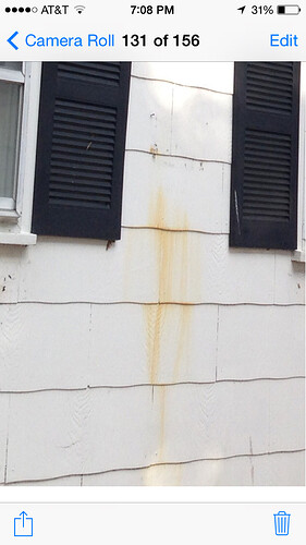

Do you think it can remove this rust stain too?
(gonna have to be a soft wash with minimum pressure - this siding is really old)
F9 rust removal in a pump sprayer, that will come right off. Then do your house wash.
