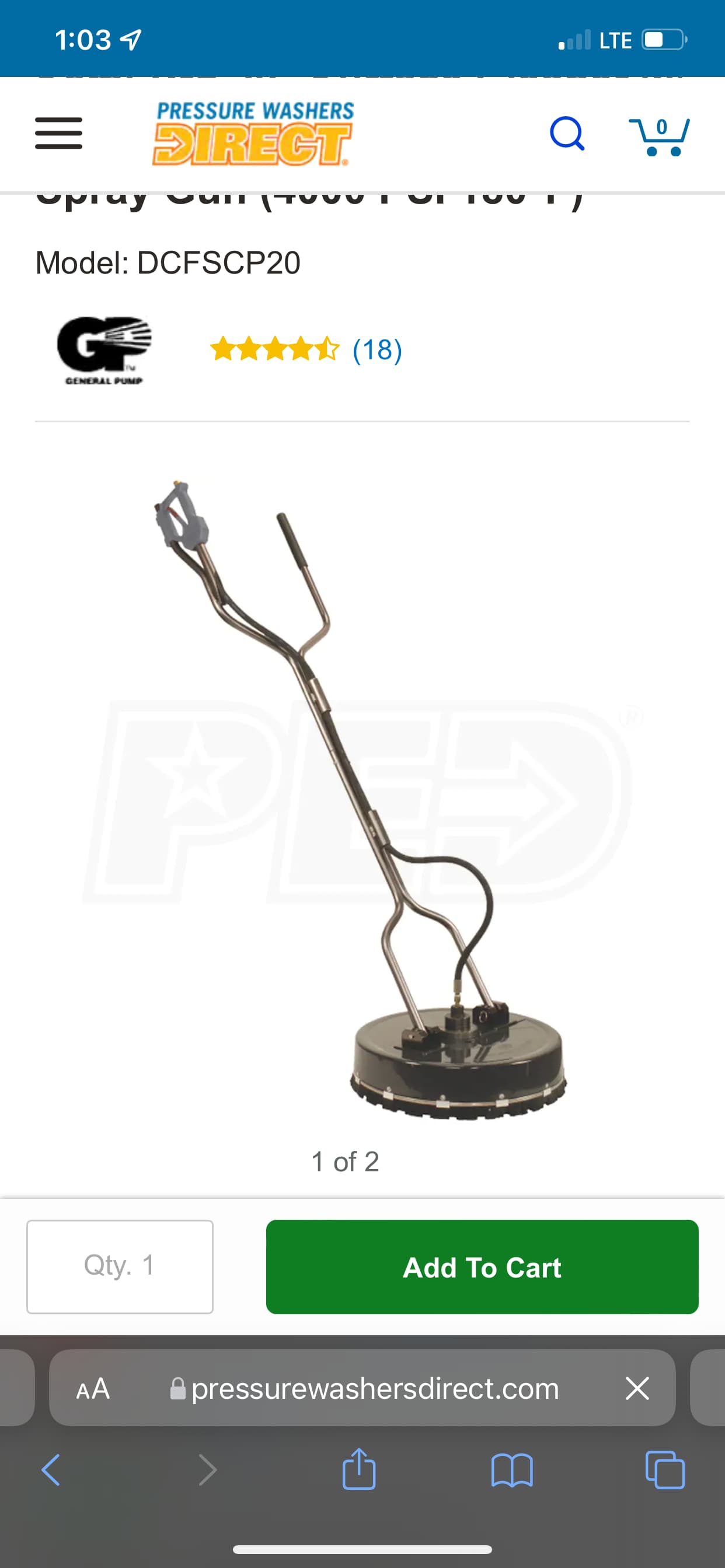

Hey guys, quick question. I’m new to the pressure washing business and have a northstar 4000 psi hot water and I just purchased a new surface cleaner. I was wondering is there was a high pressure valve that I could put on the end of my hose so I can switch between the wand and the surface cleaner without turning my washer off and on? Thanks!

You do not want that one. That one will get you hurt
What surface cleaner do you have?

Don’t buy that. It’s junk. Get a 16inch eagle wash
too late ![]()
Take it back, or throw it away. I’ve bought a lot of stuff that turned out to be junk. Buying it doesn’t mean you have to use it
I wish I would have asked before a bought it. That’s what I get for not being patient. It will have to do for now. I’ll for sure put that eagles wash on my next to get items.
Put it up for sale on Marketplace, it’ll sell quick.
Whisper Wash surface cleaner all the way……I’d sell that before you use it if it were me. Much success though.
