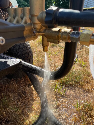

Pressure washer pump was leaking today not sure what this piece is?
Noob question here but on the bottom of my pump there was a small fitting that had a spring in it. It not sure if it’s part of the unloaded or not. It’s not the thermal relief valve. It was loose so I tightened it and it stopped but what is it?
That’s AAA’s “Pressure Boost Valve Kit”.

Thanks, what exactly is that for? Was it supposed to be loose or did it just loosen over time. Did it start pissing waster like that because of something I did ?

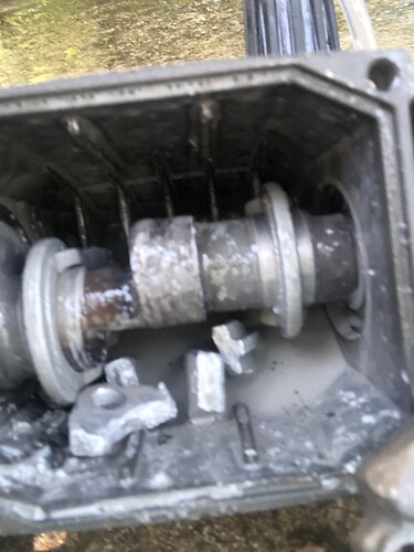

Reminds me of my old 3.5 gpm unit. No need for a diagram here. Pump’s already exploded
I remember seeing that photo. Right around the 4th of July, oddly enough. Looks like somebody hit it with a car.
Wasn’t a car. My room temp IQ hit it by letting it overheat. Now I’ve got a belt drive and a buffer tank so I dont make that mistake again
I think it is AAA’s way of getting just a bit more pressure out of their pump for a marketing advantage. If you look at the same engine with a CAT pump on it it’ll claim to only go up to 3,800 psi, where as the AAA states 4,000psi. Couldn’t tell you if it really works or not. I don’t own a pressure gauge and have only used one on my air compressor.
