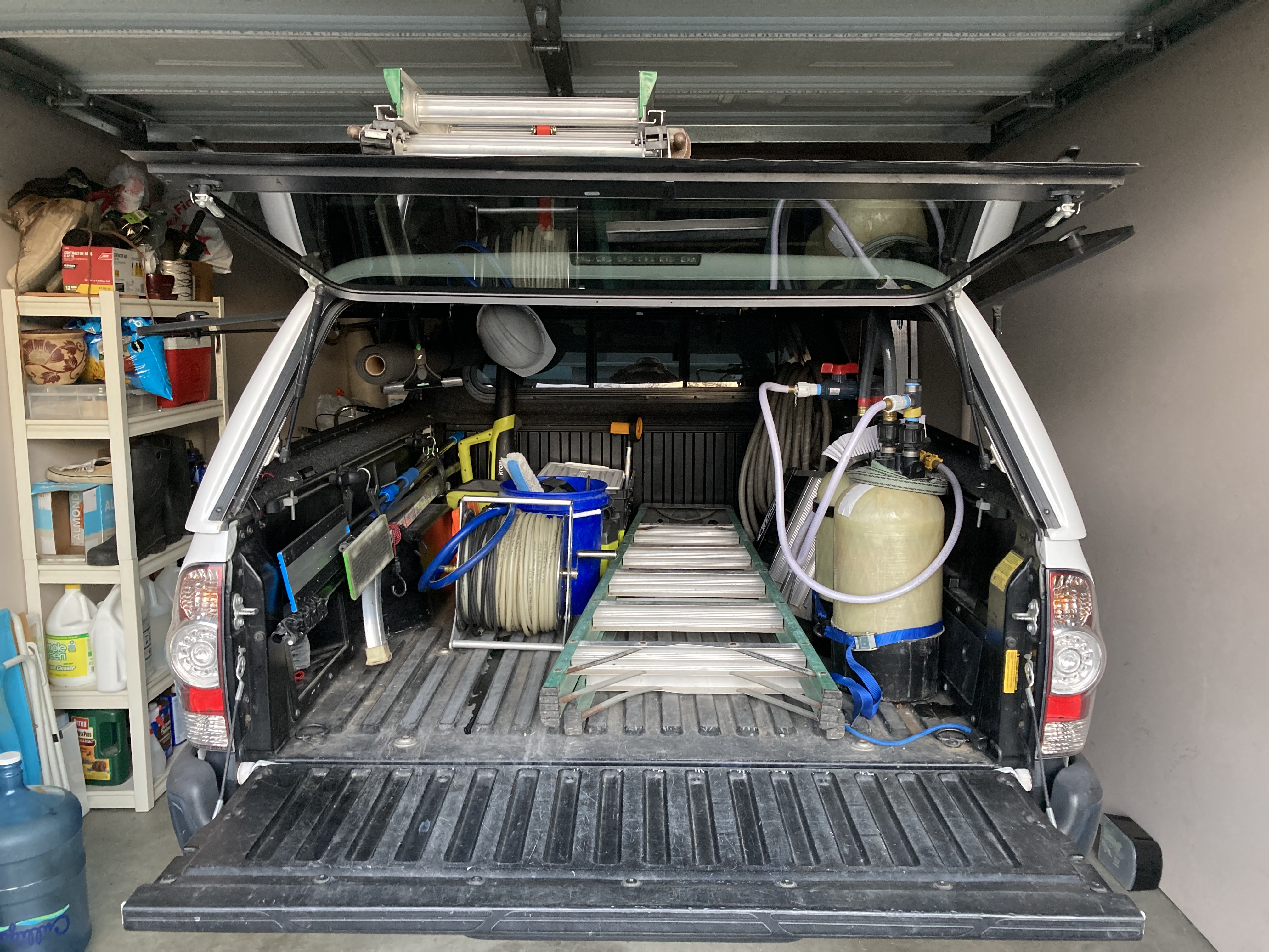

I’m doing windows from my truck that’s covered with a shell. For the time being I’m aiming to use the machine weekly not daily. Does anyone foresee any major problems if i run the machine on my tailgate connected to a 35gal buffer in the back of the bed? I was worried about too much heat and not enough ventilation. I could leave the side windows open I guess. Any thoughts? Anything else I should be worried about?

Here’s a picture of what i’m working with
Yeah you’re definitely going to need a trailer. Buy once cry once is your best option
Agree on a trailer, 5x8 doesn’t cost much.

Eventually the goal is to get a van. If possible, i’m trying to make the truck work for now. This small garage is all the space i have to park equipment, I can’t do a trailer at the moment. I can make room in here to house a small buffer tank and to load a pw and reel when I need it. I really don’t want to load and unload the pw on the job though, hoping i can run it from in the bed if that’s safe.
I’ve been doing research on which machine would be best for my situation, but i would like to make this purchase before the end of the year so I appreciate your input. Just want to make sure I’m not buying a piece of junk :sweat_smile:
It’ll be fine for what you need. Just turn it where exhaust aims out the rear, long as it’s out near tailgate should be ok.
@treacherousbogart you could consider a bed slide. That’ll make it easier to access things further up in the bed. I’ve never owned one so I can’t say from experience as to how well they work but it might be worth looking in to.
