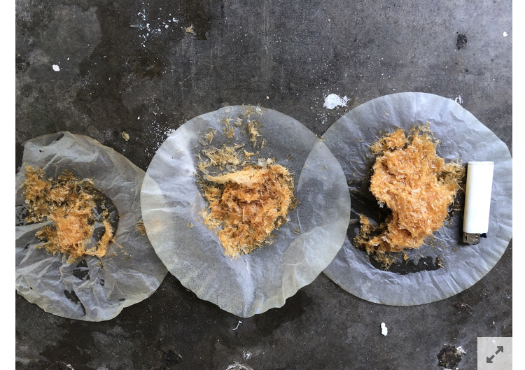

57.9 hours right at 20 housewashes and a doctors office. It’s just a bad batch of gas tanks.
This was @CFH haul
This was mine on 2nd cleanout.

Mine came back again but was similar to your 2nd haul. I did not clean the tank out again (just a real pain having to unplumb (I just made that word up), move buffer tank, move skid just to get to where I can take tank off. I just change my fuel filter and kept going. Hasn’t come back since but I now keep several fuel filters on my truck just in case.

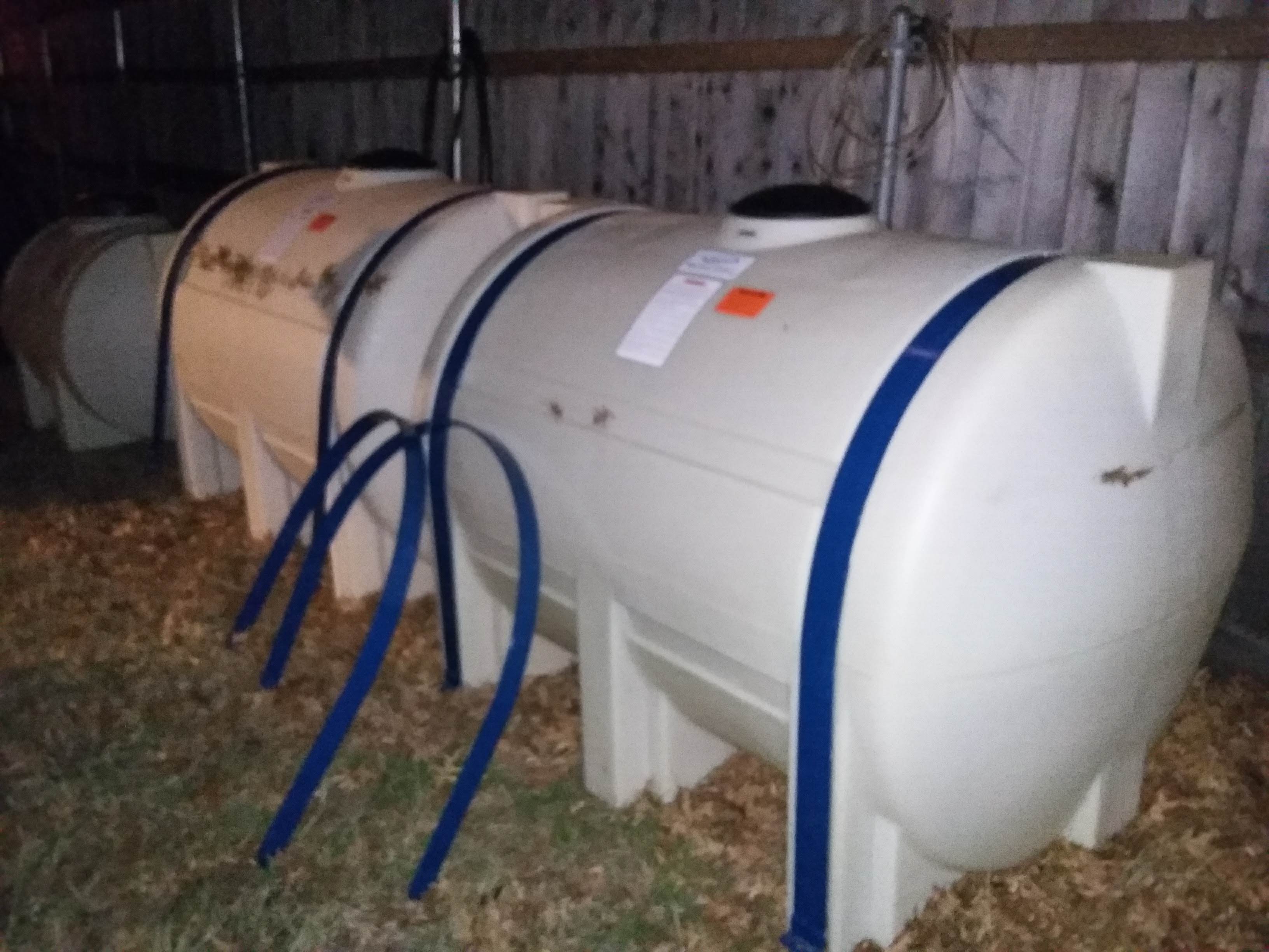

@CFH It’s not. They’ve gone to Black XLPE with red cap like @dperez is talking about.

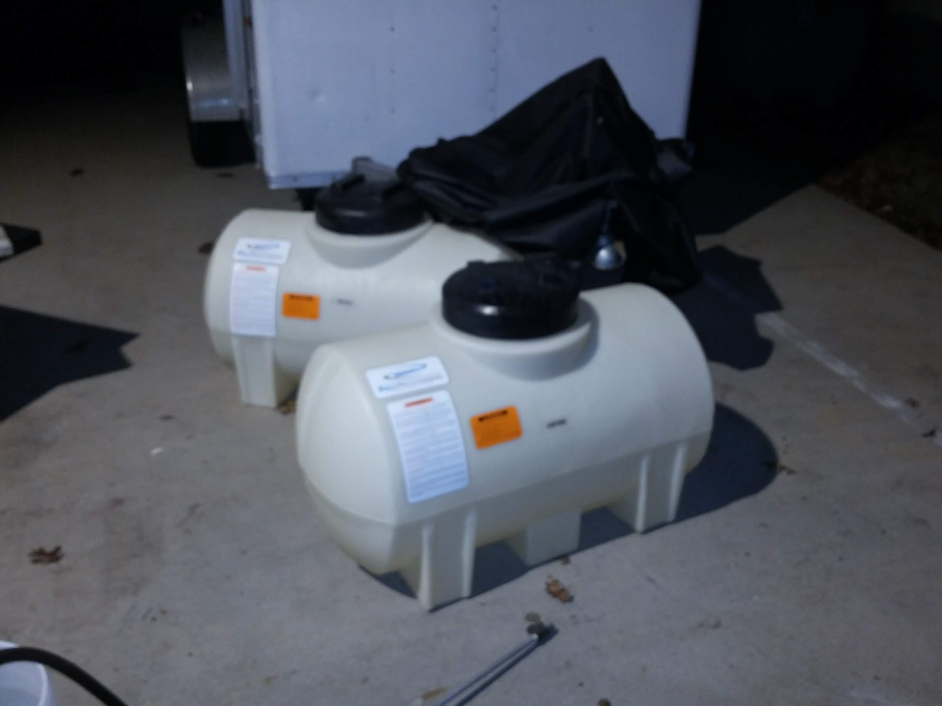

I’m in the same boat ,you see it’s pinned against the rail on mine. I have a fabricator who’s a buddy and has a forklift but he’s booked solid right now. Otherwise it would be facing the front off the pallet and bolted to the trailer.
Well there you go! XLPE is no joke they turn tanks into beasts. Some of my oldest tanks are over 30 years old. They are pricey but well worth it. The last 5 tanks I picked up from Poly Processing in Monroe Louisiana were almost $4,600
