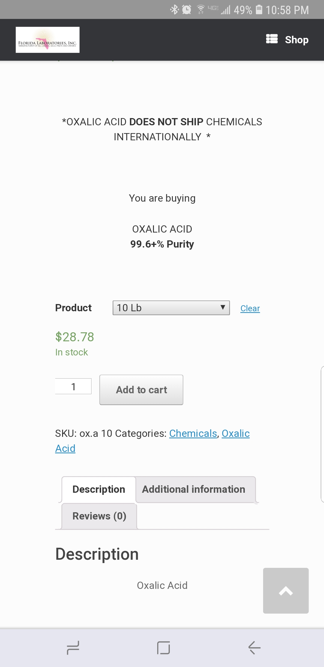

Also, that’s only two pounds of oxalic in that bottle thing you posted. I’ve never had a problem with the stuff I get from Florida Labs.
Lol cheaper on amazon than direct. Gotta love it!
They told me that on the phone once. I use to call to order and then the lady was like, “Do you know about Amazon?” Haha
