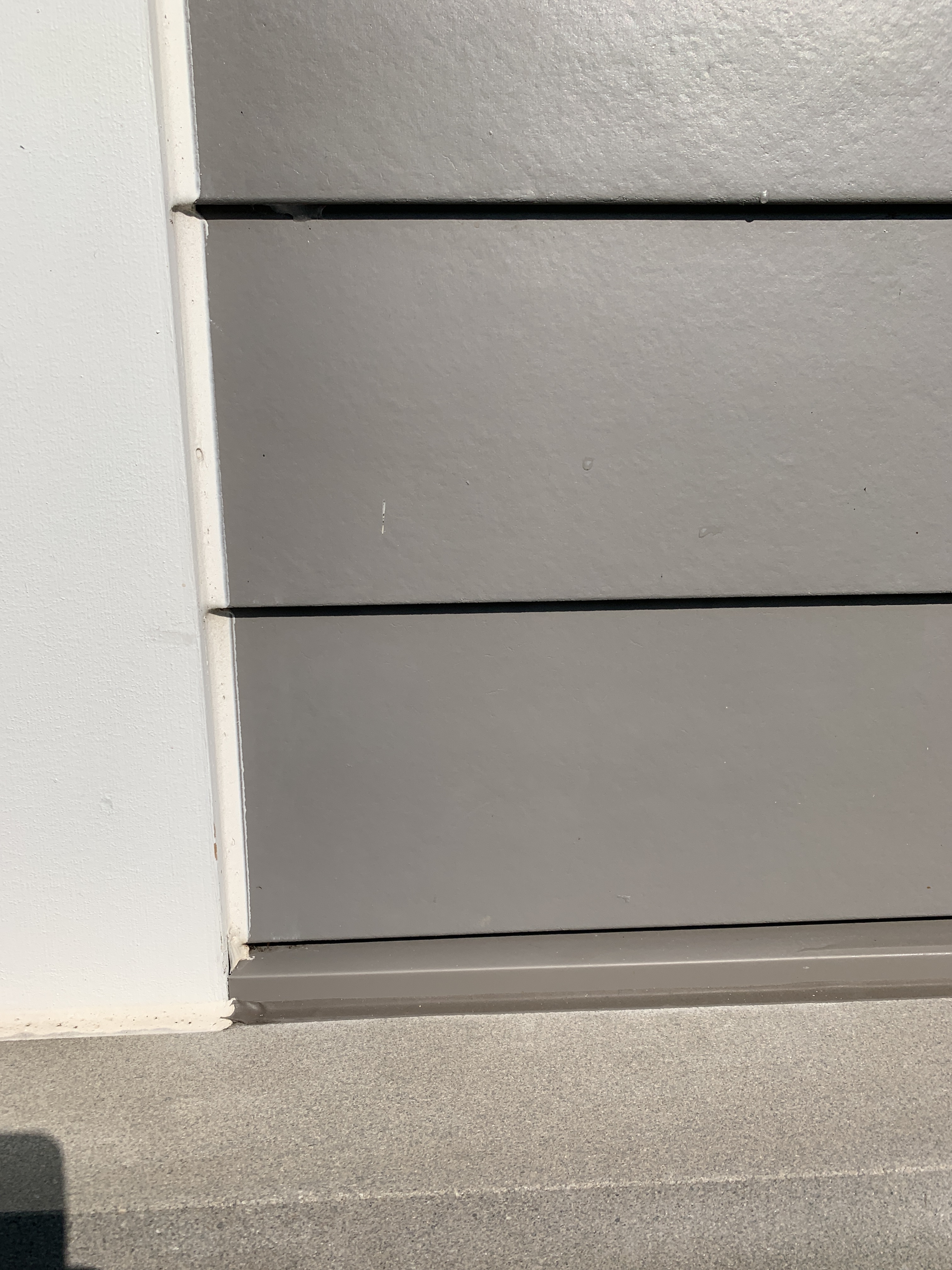

Possible Oxidation before soft wash?
Yes I did heavily too and it was diluted a lot the mix
Just used a 5% mix on this house (SAME EXACT WOOD!) different color. Nothing has happened and it’s exposed to sun!
this was my test spot area

That doesn’t mean anything. It’s not the wood that’s the issue. It’s the paint. Some paints contain organic pigments and it will do pretty much exactly what your picture shows.

I’m not sure which procedure you mean. I don’t think I ever mentioned one in this thread. 5% is way too hot for almost every painted surface. If I’m washing a painted house I’ll always test in an inconspicuous area with a spray bottle of a strong mix. I then know it’s safe for my regular house wash mix. There’s really no need to use a strong mix on any house unless it’s brick or stucco with some bad organic stains. If I notice that the SH does affect the paint I’ll just use surfactant. I only do test spots on painted houses. Don’t ever wipe a house dry by hand. If it’s oxidized it’s going to show. That mainly goes for vinyl but can also happen with some older paint.
Yes, 4% can hurt a surface that might be fine with 1%. If you’re not careful you could etch glass with a 4% mix. If you used 4% on a painted house and, there were any cracks or pinholes in the paint, it can get underneath and cause the paint to come loose. This can happen with only water too but the SH definitely causes it to happen more. A lot of guys won’t even mess with paint. You definitely have to be careful.
