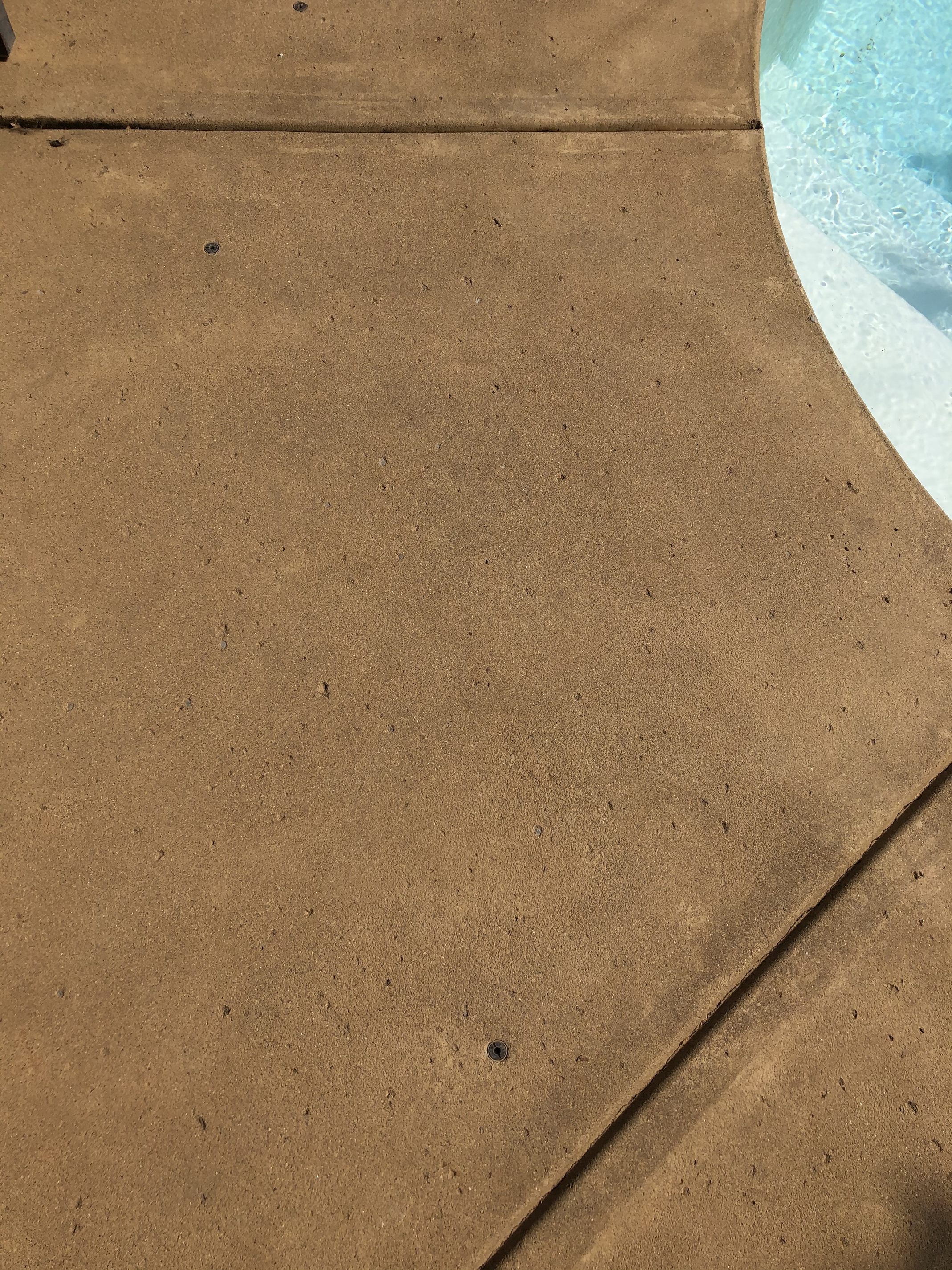

Just checking with the pro’s…
They want it done in the spring (as usual). I verified it’s through color and not painted, just a normal surface clean and post treat?
If it is tinted concrete, then my understanding is that the tint is added when mixing. If so, you ain’t gonna wash that away. Regular procedure as you suggested.
Be careful. Do a test spot and wait for it to dry! Be really careful with surface cleaners. We did one that was supposed to be an integral mix but learned from the construction companies that sometimes the top will have more color and it can come out. Usually happens after UV damages the surface over years with no sealer to protect it. Also use oversized tips and even 25 or 40 deg to not hit too hard on the surface.
