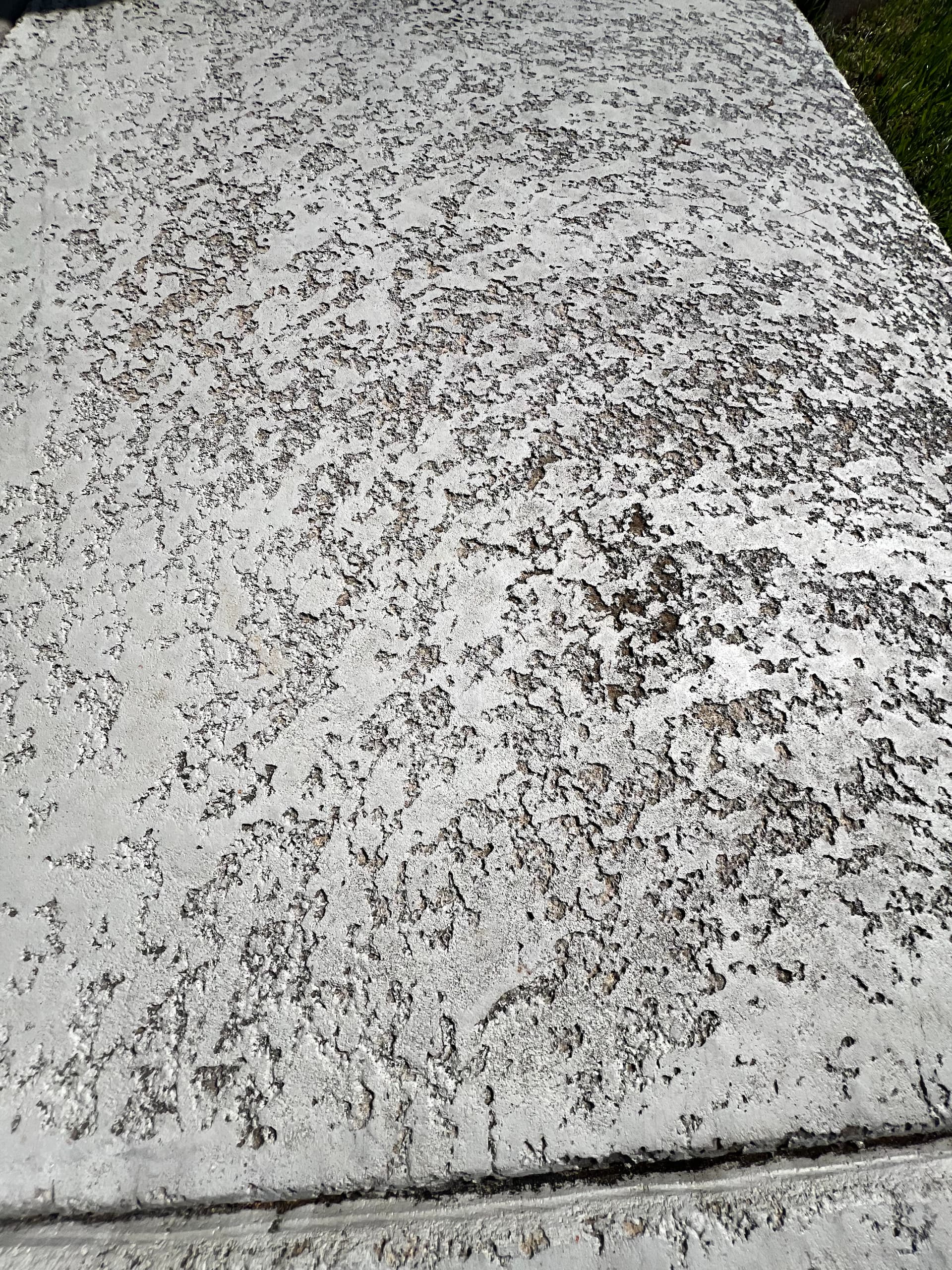

Does anyone know what type of coating this is that is put down on top of concrete around swimming pools? I’ve seen it quite a bit around my area but am not sure what it’s called.
Cool deck, you can soft wash it. Don’t want to put a SC on it.
I put 3-4% let sit for a bit and ball valve rinse. The ones I’ve done cleaned up nice and quick….
Kool Deck… another vote for good pretreatment and medium pressure rinse

I’ve cleaned cool deck with a surface cleaner no problem. low pressure.
Yes, I have too. 600-800 psi
