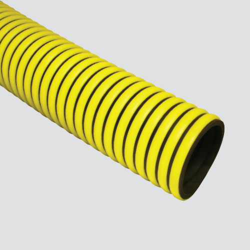

From the ball valve, vacuum hose to filter, vacuum hose from filter to machine. One inch. Don’t used the reinforced hose. It will collapse when it’s hot
Something like this, but in 1 inch
Really! Awesome thank you sir
Agri supply, if you have one close to you.
