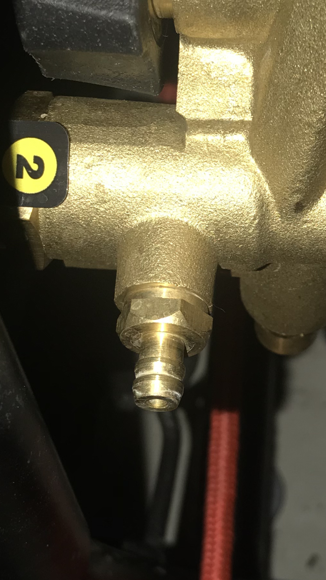

Can you snap a picture of the injector and post it? I tried looking online but can’t get a close enough view.
I’m an idiot; looks like it’s threaded. Looks like a brass plug should do the trick. What do you think? Thanks again!
Just remove the barb and there should be a spring and ball. Just pull out whatever will come out. Take the barb to the hardware store to match up the threads for a plug.
