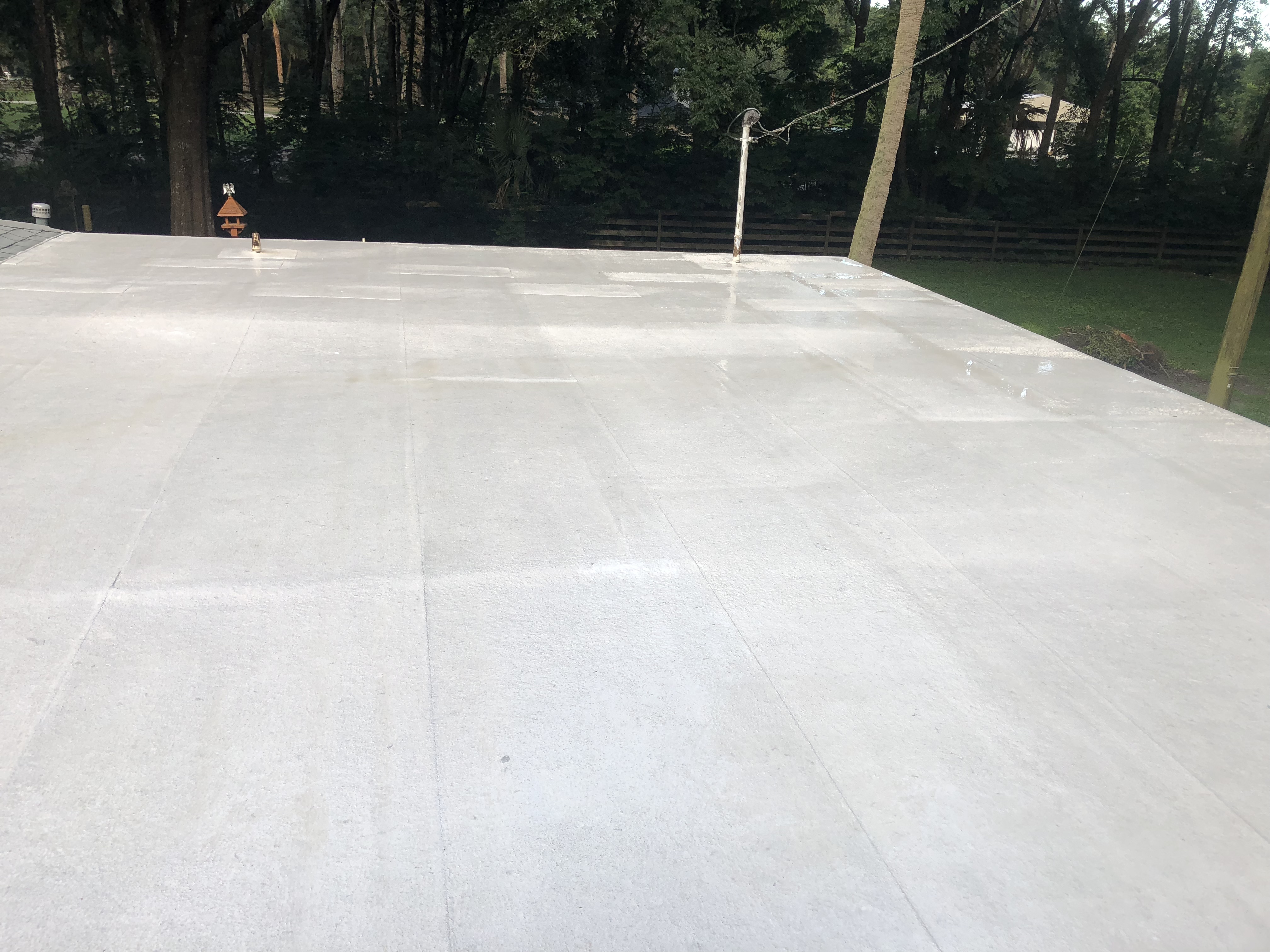

Thanks for all the advice. Job went well. Started DS on the back side to test; not bad but too long. Sprayed the rest with pump sprayer…much faster and efficient. I was using 10% SH. Haven’t found ( nor looked hard enough) 12.5%. 2,000sqft/26gals SH.
It was my first roof. Happy with results and lessons learned.

Not bad at all for your first one. Looks good and that was a pretty nasty one. Take some of your profits and go buy you a 12v pump. Would have saved you a lot of time.

Thanks! It’s in my near future. What would you have charged for this job? Still working out pricing. I charged him $400…gave me $500.
You were about right. I’d be at .20/ft on that one. Maybe a tad more because it was pretty dirty. Got one about like that I’m doing for $450 next week.
