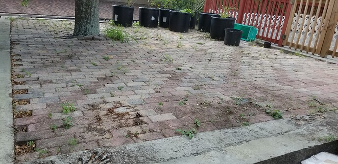

What is the correct way to clean this type of flat work? I don’t know anything about pavers or how they are installed correctly LOL but I’m always trying to learn and do things right for my customers. I understand this might be a debatable topic so let me knkow what’s your opinion. Thanks!
Tell the customer to pull the weeds or you charge them for it, surface clean, rinse, tell customer to buy and lay down more sand after you’re done.
Ah yes, patio pavers…my arch nemesis.
The weeds will need to be either pulled or weedeated, then a strong mix of SH to kill off the organics. You may get by with a surface cleaner, but the really nasty ones required a turbo. Either way it will blast out the sand so either you or the customer will have to re-sand it.
Paver patios are huge money makers for me. I’ve done a ton. Strong mix, let it dwell, surface clean/turbo. Get as much of the old sand out as you can. Come back on dry day, install Alliance G2 sand, wet it. Come back in a week and seal it.

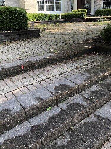

I do a lot of pavers too. Use the SEK/Trident products too. Nice job on this one. Looks great.
Thanks, I don’t do them too often because they are a pain lol. We tell customers we only do them July-October. It’s not worth trying to work around the weather in the spring especially cuz we’re so busy already. Save it for the dry slower months
