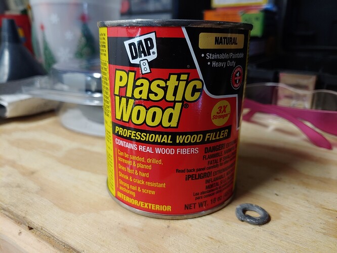

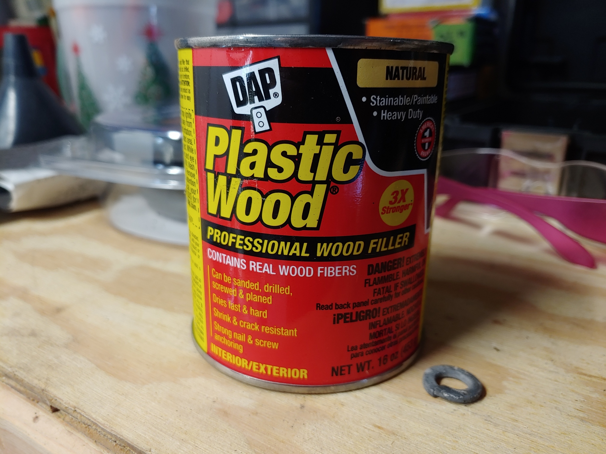

I used this last year to patch some bad spots on my plywood floor of my enclosed trailer. I paint the floor every year but years of water, sh and 5 gallon pails slamming downb the floor developed some rot. I patched it, sanded it and painted it. The patches held up way better than I expected.
That stuff’s awesome, I dont even buy the stuff we sell I go to our competition to buy that exact product.
What kind of prep work we talking with that stuff?
Depends, for simple patching, just make sure any loose crap is out of the hole, if it’s a big hole I’ll drill some “grab” holes in different directions in the hole, blow it out, fill her up with filler then let dry. Use a chisel to clean it up, hit with a rattle can of primer, then paint. It’s my favorite wood filler for stiff that’s getting painted. You can even thread the stuff… put some vaseline on your bolt, pack the filler around the bolt tight, give her a few screws in and out, then let it dry and unscrew the bolt.
It will hold screws no problem.
