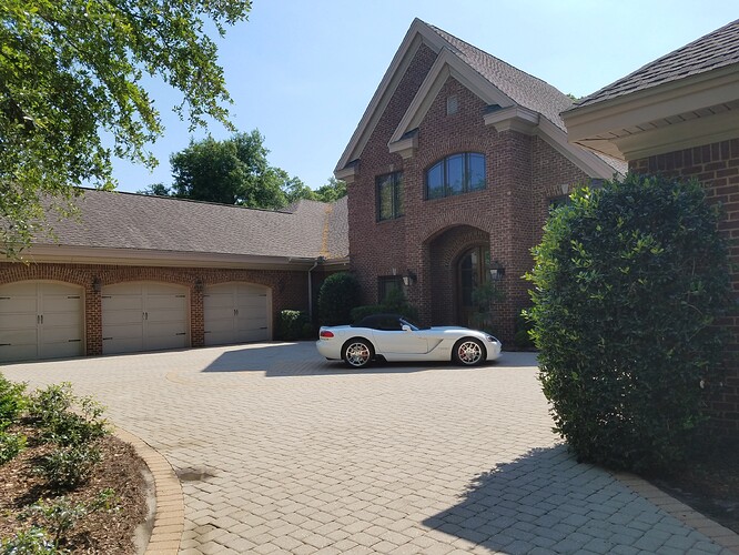

Side note…check out the driveway i washed yesterday
