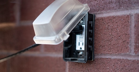

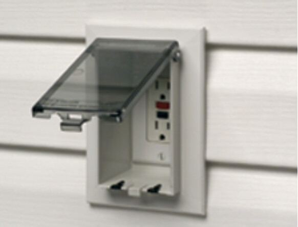

These are the three main ones I see around here. The first and third work fine with just a shower cap since they have a “lip” to hold it in place. For the middle one, I use the orange FrogTape (the heavy-duty kind for non-painted surfaces). I open the flaps, place a strip across, then close them and cover it starting at the bottom and working my way up. I missed one of those last year because it blended in perfectly with the brick and ended up popping a fuse, but otherwise I haven’t had any issues.

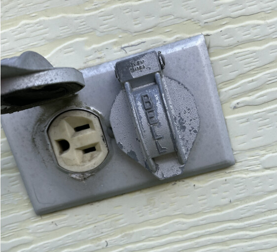

These are the ones that seem the most problematic for me. A couple years ago I burnt out two of them at a condo complex. It was a rainy day and I couldn’t get the tape to stick so I just chanced it. Doing the same complex starting next week, and don’t want a repeat of that situation :sweat_smile:

I’ve fried two of these so far, one kept smoking and scorched the interior wall. The customer actually thanked me in a way, the electrician said it was installed improperly.
