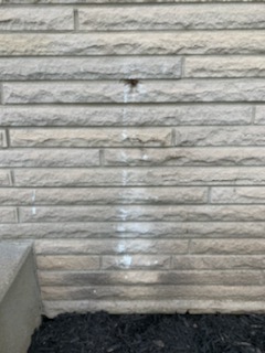

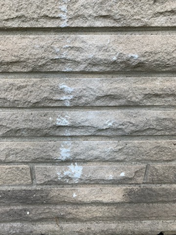

Hey guys, hopefully easy question for you. Have a paint stain that the customer would like removed from a stone wall. I spot tested with paint thinner and a hard bristle brush and it did not do anything. Told the customer (a friend of mine) I would do a little more reading then try again once I find a solution. A couple guys in the F9 Facebook group recommended I use “World’s Best Graffiti Remover”. Do you guys agree?IMG_02031 IMG_02001
Paint thinner won’t do much at all on dried paint. Grafitti remover works, as would acetone or xylene. The clean spot will be noticable
Got ya, thanks! I think I’ll try the acetone first because it’s initial cost is the lowest then work my way up if need be. You make a good point with the clean spot thing, I’ll definitely have to set those expectations very clearly beforehand.
