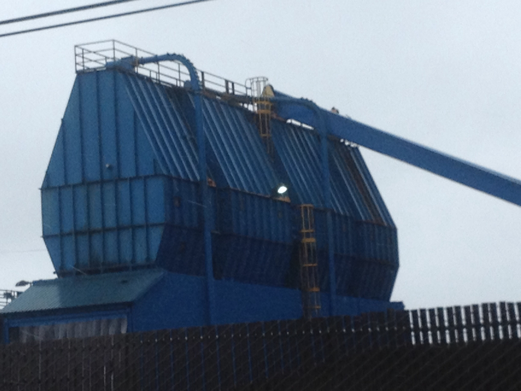

Hey guys I have a local saw mill wanting the upper half of the chip hopper pressure washed so they can paint it. It’s up starting at 30ft up to 60ft. I’m unsure if I’m gonna have enough pressure to clean it properly?
I’m currently running real time 5.3gpm at 2800psi at the wand after 100ft 3/8 hose I believe I’m going to be in the 2500psi range with another 50-100ft of hose and pumping up hill to my lift at 30-60ft.high
I know I can clean it with chemical but paint prep and cleaning can be a different story. Any advise is much appreciated.

I estimate there’s 7,500-8,500.ft. Of surface area and with my setup will take a minimum of 25-30hrs
My ideal setup would be Hot8gpm at 3200psi at the wand I’d guess I would just get to work and would take estimated 20-25hrs with that setup

Pretty much. I personally feel it needs soda blasted/or higher pressure 4000-4800psi but I’m pretty much the only guy in the area. I don’t want to loose a work just cause I’d do it differently if I could.

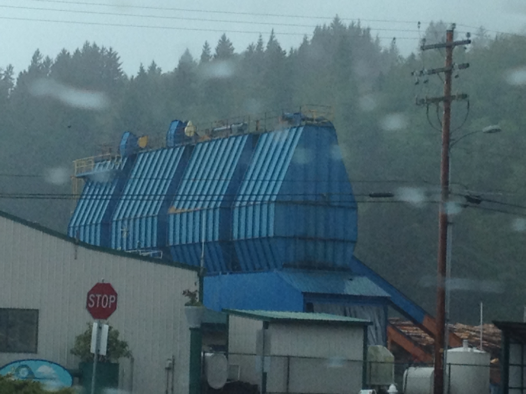

Ok there’s some pic it’s the hole upper half total height is 60ft. Est. 55ft long and 15-20ft wide at widest point.
