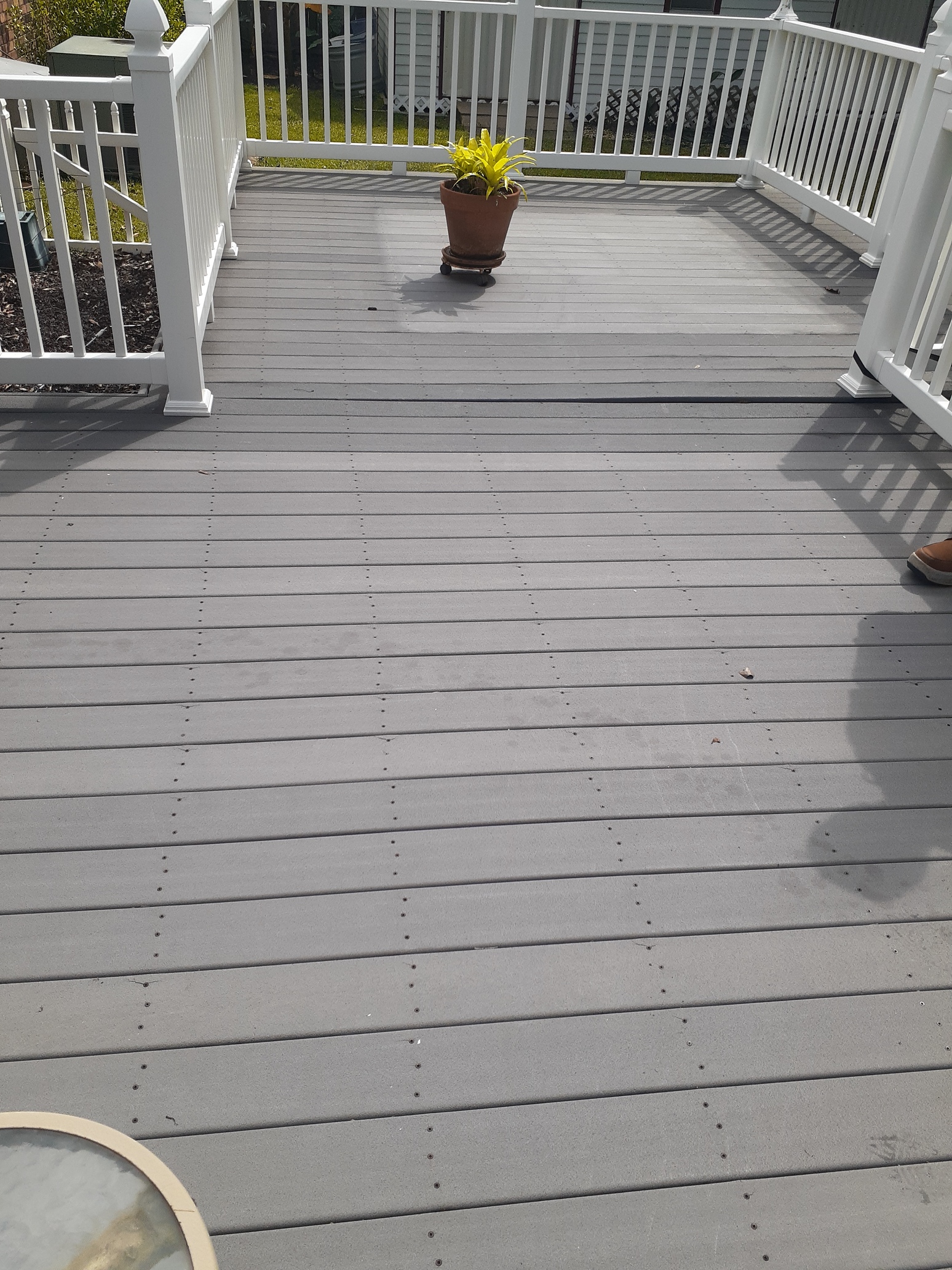

Did the Trex job today, it had a ton of lichens and old algae. 3%, dwell and 800 psi rinse. Took awhile but came out really nice.
Pics ?
Totally forgot to take one. I was so busy packing up it slipped my mind.
You can see the rails in this one at least.:laughing:
