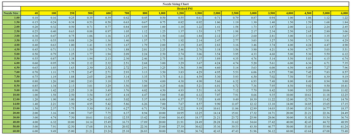

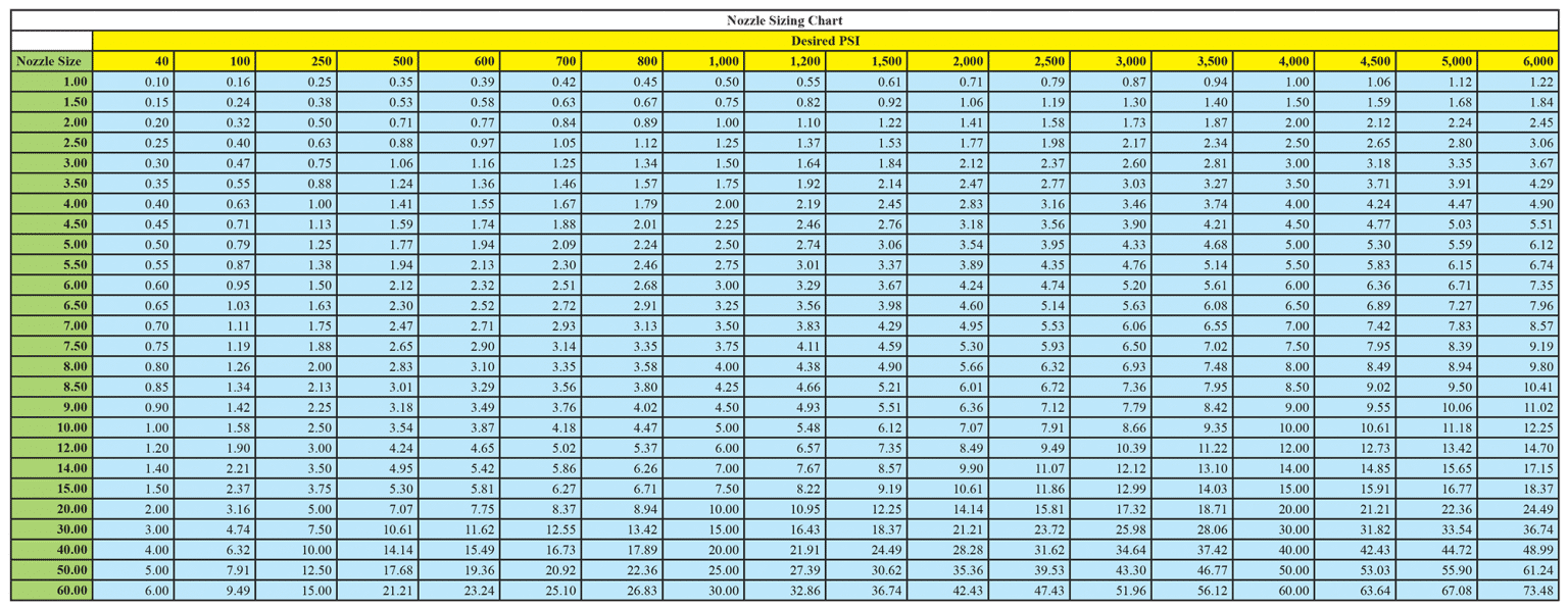

Sorry, just sorry I know this has been discussed but I’m just not getting it. Tried here and YT and I guess I’m dumb.
I’ve got a 4/4000 machine. I look at this nozzle chart and see if I’ve got a 4gpm 4000psi machine I need a 4.0 tip. Got it.
If I want to know how much psi and gpm a different nozzle would give my 4/4 machine how do I figure it out?
Go across the top to find the PSI you want to achieve… move down that column to your machines GPM or close to it (if using a surface cleaner split the GPM by how many nozzles the surface cleaner has)… Move across that row to the left to find the orifice size you need for your nozzle to achieve the PSI.
That makes perfect sense. Thank you!
