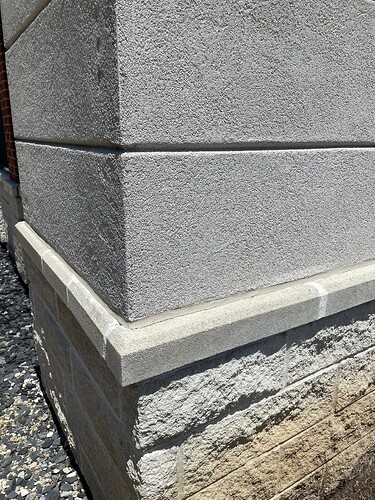

Need to quote a commercial building, not sure of the surface. It isn’t stucco, have seen some threads in the past naming the material but when I typed “not stucco” in the search bar I don’t see what I’m looking for. What is this material?
EIFS? Not sure, kinda looks like it.
Ask the customer lol
Dryvit is the popular brand, but yes most likely a type of EIFS… what’s it sound like when you knock on it?
