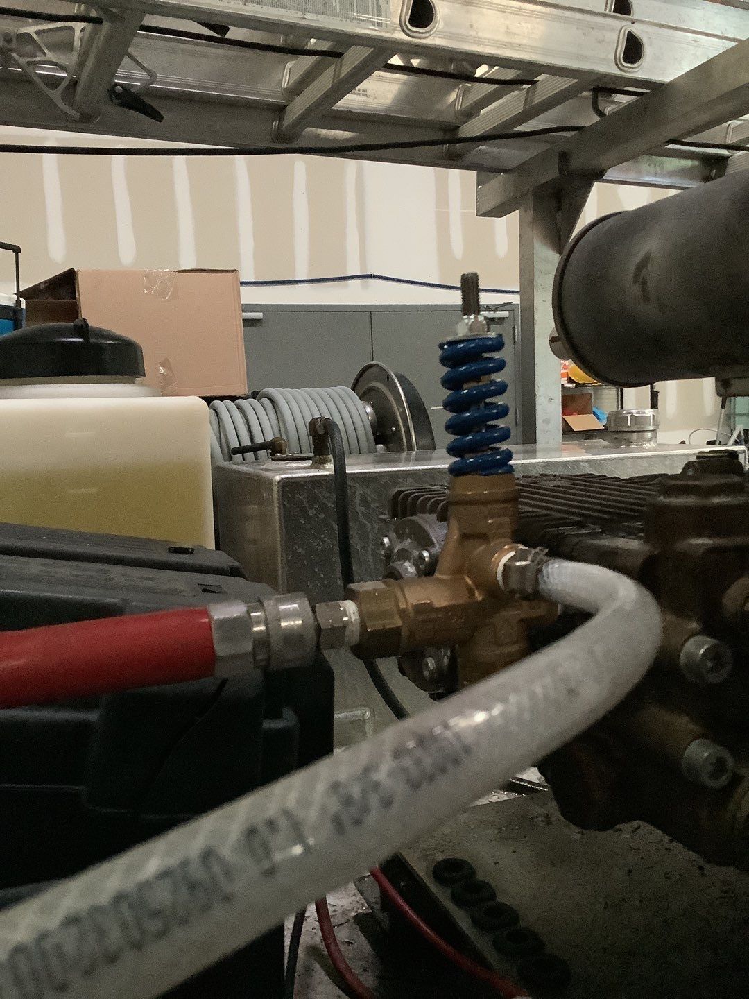

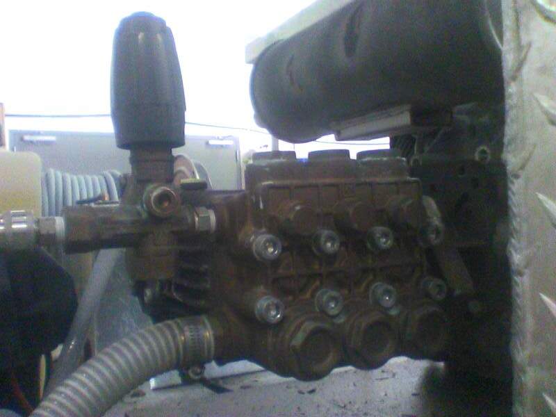

So long story short, I’ve got these things (well 1 so far, but know the issue) up and running again, but nothing I do will work with the unloader. We’ve put on the old white tip (which I assume is the one that came with these machines last spring), and I crank the unlader from top to bottom and have a constant garden hose like flow of at least a couple gallons a minute or more…New unloader (AR VRT3-250 Blue spring/3650psi on a 8/3500 machine)…anyone have any insight? I can’t understand why this isn’t working…
Pics of unloader and set up now, including bypass my what is bypass doing when you try to adjust unloader
This, except I moved the water intake to the right hand side of the pump, and the bypass line out of the side of the unloader facing toward you in the pic…otherwise, this is exactly it. It’ll be back here in an hour and I can retake if needed, but hoping to have some clue why it won’t set.
I can try and get a video, but basically the flow never decreases at all as I tighten it all the way down, or if it does it does so slightly. It’s a pretty solid few gallons a minute out of the bypass at a minimum when I was running it into a bucket last night. So I stuck a brand new one on there and same result…
I’d like a close up pic of the unloader. I don’t think it’s plumbed right.
As long as you do like the injuns and follow the arrows. Just trying to start with the simple stuff and work thru it. I assume you got the proper tip, probably a #9 for your machine. It’s a pressure unloader so you aren’t going to get anything going without a pressure tip. All else fails, call MVP and ask for Diego. Tell him I sent you or he may hang up since you didn’t buy it from him. He’s the smartest guy I know in this industry. [Name] Mvp

Unfortunately it’s now spraying gear oil (I think) everywhere…I think a seal got lost in the process of it falling apart ![]()
