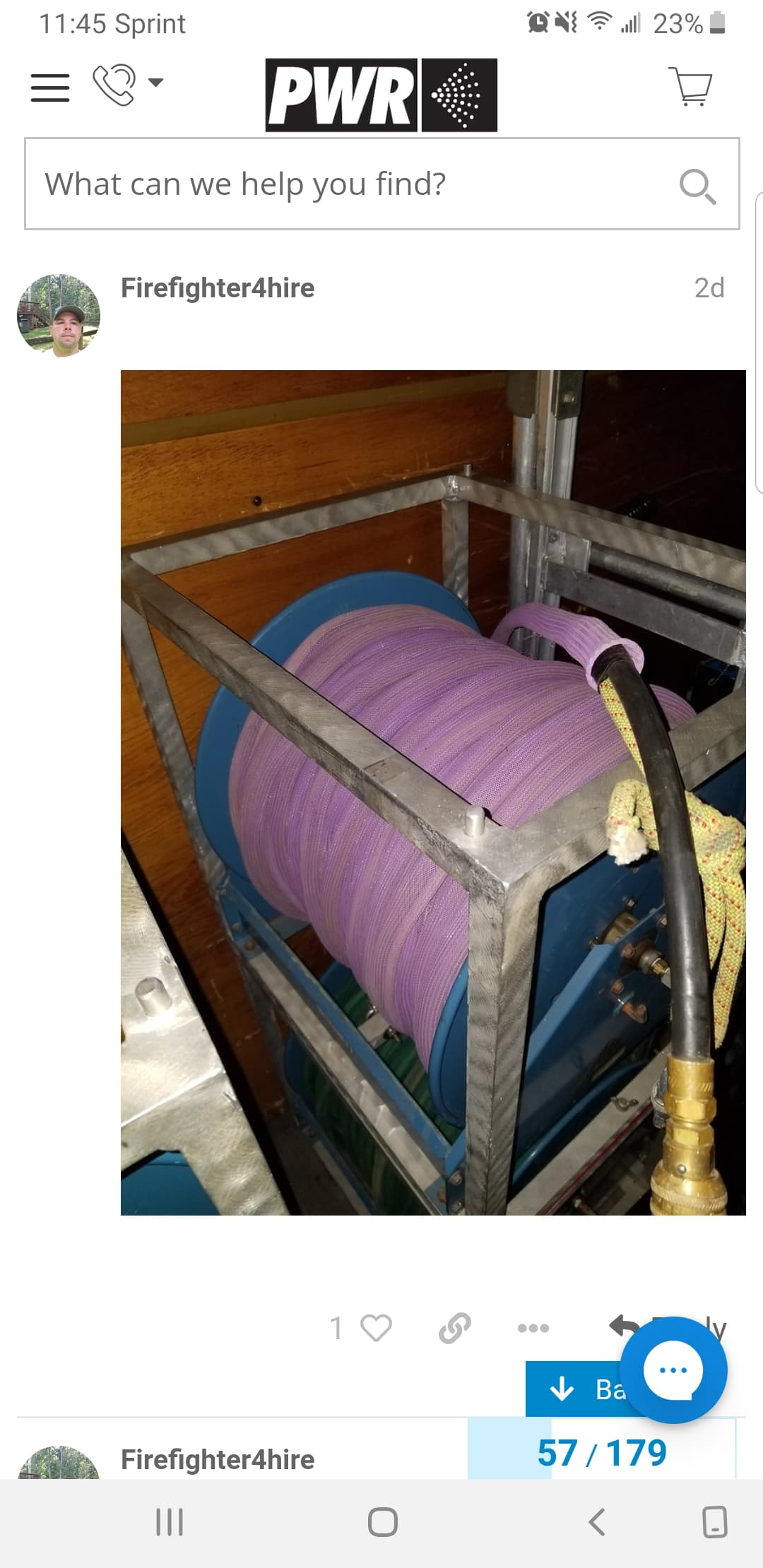

I cant remember what this was called but someone on the forum either did or still uses this

That’s called nylon sheath. That practice is commonly used as a safety buffer for high pressure line bursts, not really suited to dragging on the ground all day. Probably not a bad idea for RV cleaning work as hose lengths don’t need to be very long I would imagine.
