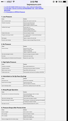

This troubleshooting guide might help you out if the link works. This forum is primarily for contractors and if you are a contractor in this industry, filling out a signature will allow other members of this forum to know where you are located. As a result they will be much more likely to respond with sound advice. However, the pressure washer you are currently using is a consumer grade pressure washer at best. It only has a two year warranty after all. Members on this forum don’t use and or service consumer grade pressure washers. I would suggest for you to buy a professional grade machine with at least 4 gallons per minute and belt driven. IMHO if you have to replace the pump on your current pressure washer you’re throwing away money that would be much better spent on better equipment.
