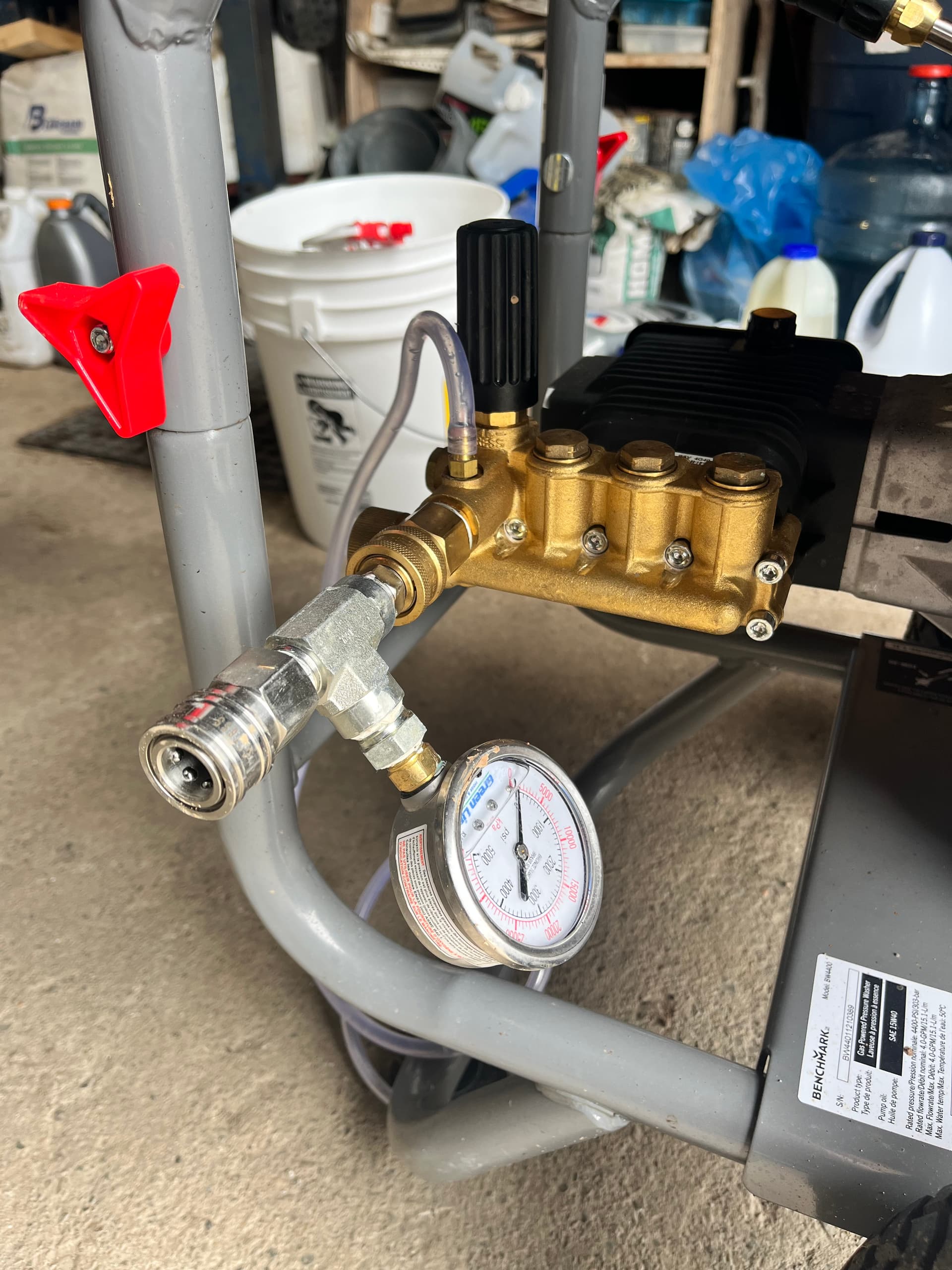

The machine I picked up is a 4gpm 4400psi, came with factory downstreamer pictured here,

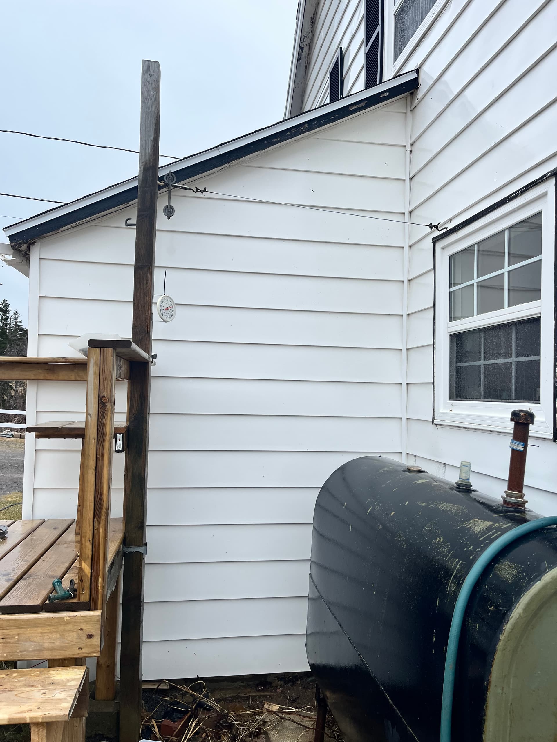

The manual said the DS pulled at 1:25, which didn’t mean much to me without much knowledge but soon came to find out that would be an issue. Did a ratio test and had seemed to be getting about 1:20 pull from the DS. I tested out different strengths of SH mix and realized that the little bugger aint gonna cutter, although I did manage to clean some siding, it took time…and a lot of questioning myself… and decisions in life and… thinking my wife is going to kill me for another crazy idea I’ve had.
I purchased a 2.1 ds injector yesterday, plan to test it out when weather permits. Which leads me to my first question, should I be putting some windshield washer fluid through the pump after use if its going to drop below 0°C (32°F)?

And lastly, for now… The picture above of my pump, is that considered my unloader? I understand the use of an unloader but in my manual it says its a pressure regulator and if needed to adjust it as needed. I’ve came across charts that explain the psi difference with different tips, which i plan to do but was wondering if anyone had any input differentiating the two (unloader/pressure regulator)

If I may add, my first machine had a built in injector as well, and someone on here pointed out I needed to remove the ‘guts’ of it when adding another injector to improve flow. May want to see if you can do the same with yours.
What is your best source for SH up there? Just in the bottle stuff at 6-8%? For your machine, you really need a 1.8 injector. Try using straight bleach with your Arm and Hammer laundry detergent. About an oz of soap per gallon. on a 4gpm, don’t worry about a by-pass, just pull hose or get a cheap on-off valve for the mix.

Thank you Racer, was hoping to hear from you. Yes, the 2.1 injector is pulling a 1:10 mix, I also rigged it up to be somewhat of an x-jet setup if needed. At the moment I have been buying 10.5% SH from Walmart/Canadian tire until I find a reliable source of hopefully 12.5%. Where I work we use a lot chemicals for bleaching and found a chemical supplier contact, which is about two hours away.
