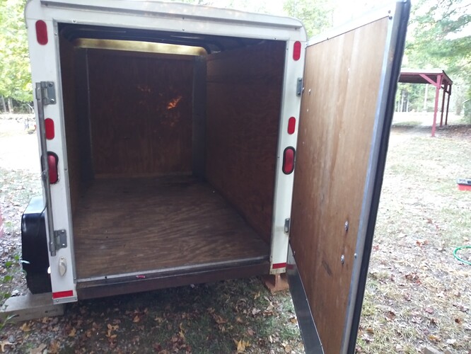

I also have a 5x8 enclosed trailer. :grin::grin:
