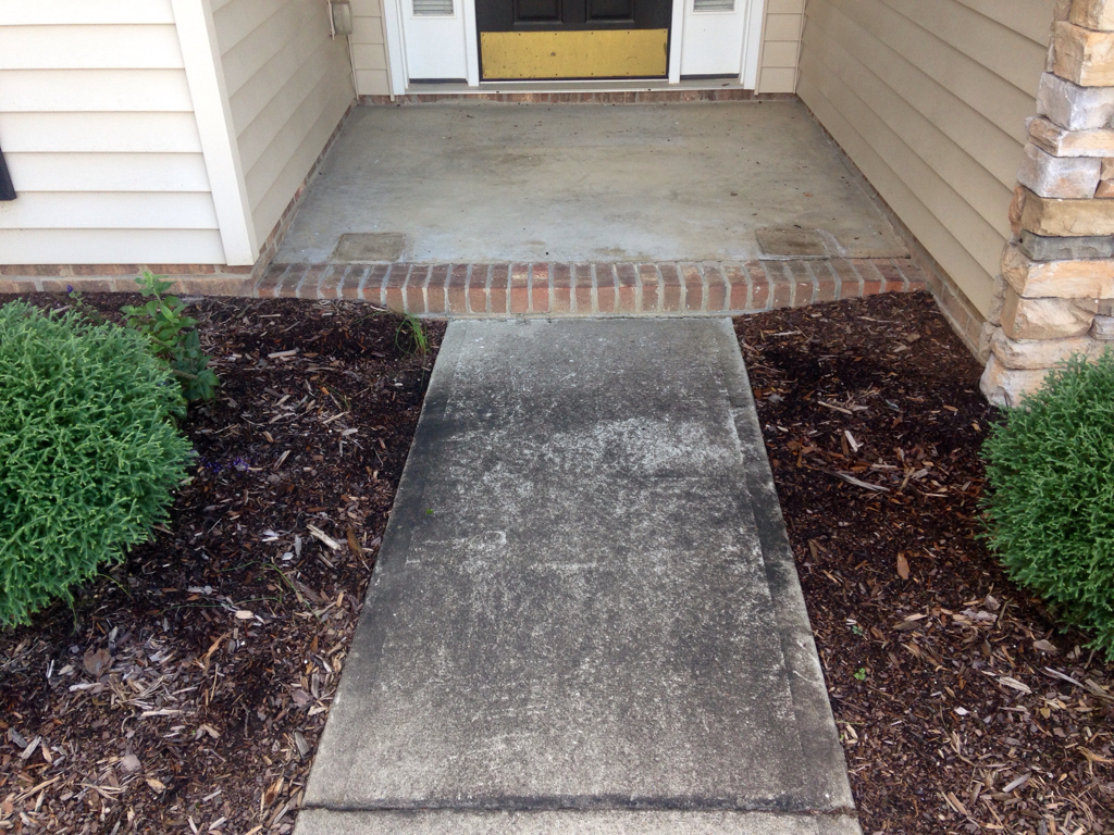

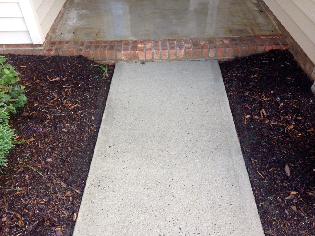

The picture below is an example. I was doing a Housewash and the front sidewalk, so, as soon as I was done with the front of the house (which I did first) I went ahead and sprayed the sidewalk. That way, it had plenty of time to sit, plus I wasn’t tracking Housewash mix all over the grass, etc.
When I did this sidewalk I left about 2-3" of “gap” in the middle.
(For some reason the picture looks like I left a stripe, but it was actually something about the way the concrete was poured and it was almost in a pattern…hard to explain, but it would make sense if you saw the sidewalk in person…It was DEFINITELY NOT a SC stripe)
