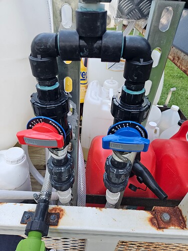

Picture? Where do you have your check valves?
I’m not a pro but sure seems like check valve issue. Helpful tip. Clear manifold helps diagnose future problems. Not saying that would help here but who knows.

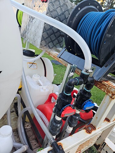

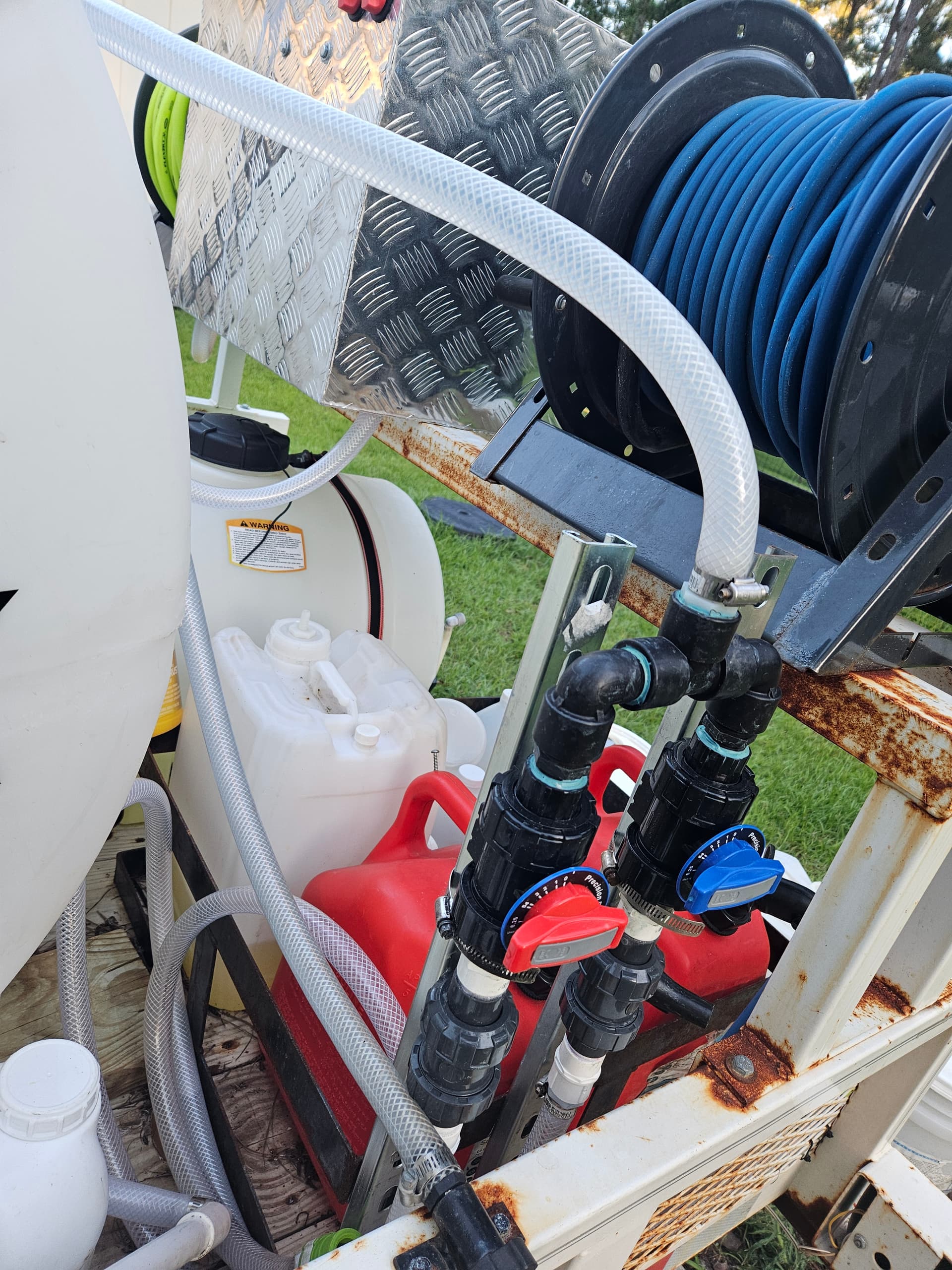

Sorry its taken me some time to get back on here… but i took some pictures today.
My water and SH lines are not the same lengths. My water has probably a 4 ft drop stick and 8 ft of 3/4 hose… SH laine has about a 2 ft drop stick and 5 ft of 3/4 hose
Check valves are below the blend valves

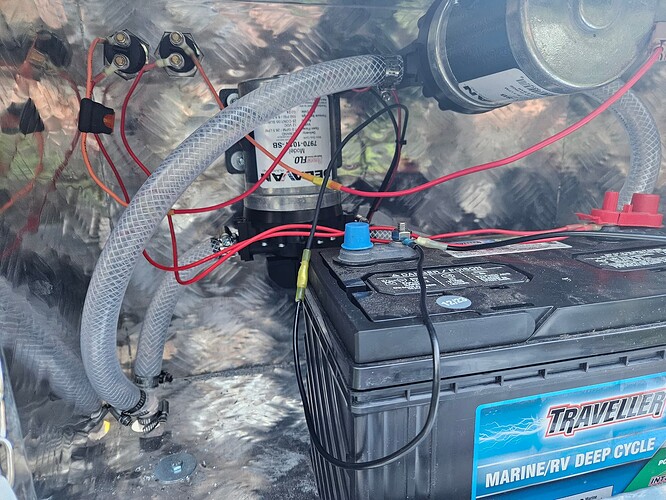

Can you sketch out your system , take a pic and post. You said you had 2 pumps, hard to tell from pic what is going on. You said you were running together? How are they merged together. Can you run one at a time? If so, have you checked your output on your valves to see if they’re more accurate.
It looks like in pic that you have a pump over your battery, you need to get that battery in a battery box
