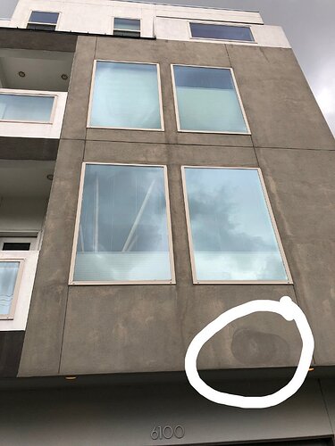

Basically this home has some discoloration/stain on the stucco that doesn’t seem to be organic - I clean A LOT of stucco, and this was my first time running into this particular “stain”. As you can see in the pictures it is only in certain areas - previously they had hired a guy to come pressure wash and he attempted to wash with pressure and you can see the results of that in the oval shape on the front. I had previously advised the client that I wasn’t sure if the stains could be removed and I would have to do tests spots - this is what I did to no avail:
  1. DS hot house mix - basically hitting the wall around 1.5% (I will attach another before/after pic that I did this weekend of stucco with this exact mix and it cleaned up fine)
  2. Pump sprayed a little hotter mix about 5-6%
  3. Tried a little bit of Oxalic
After none of this worked I told the client I would try to inquire about a different solution and get back to her. I’m aware that the only solution may just be to paint and she knows it too. There’s also cracks on some of the stucco (not sure if that matters)

I’m surprised you DS’d it since you say you clean a lot of stucco… it all would have came off first hit if you used a stronger mix. Would have saved a lot of time. As for the first pictures it doesn’t look dirty it looks like a poor stucco job. It has most likely looked the same since it was done. I would ask if it’s always looked that way. Out of curiosity, was this mark always there? Looks like it was hit with a surface cleaner lol.
Honestly DSing works for me and stucco. 9/10 times I only hit it once. These were some particularly bad stains but they still cleaned up fine. I know that I can save myself some time and chems if I were to start using a dedicated pump and that’s in the works - hoping to have it all set up by next month.
Yeah I’m thinking it was also a poor stucco job - the builder did 4 of the same houses next to that one and they all have the same issue. Yes lol the mark was there from the previous guy they called to “pressure wash”. I’m fairly certain he tried a SC or a turbo nozzle on it.

You can ds stucco if you use a super suds sucker. Are you sure that that is not some type of tinted sealer. Looks like a secondary coating to me
Yeah I definitely think it has something to do with how the builders did the stucco and I told her that. Mainly just wanted to see if anyone here had ran into the same issue.
That looks like an acrylic sand finish on top of hard coat (similar to the texture on Chik Filas-very uniform). It looks like the polymers are beginning to break down and oxidize. If you rub your hand across l aggregate would come off and leave chalk on your hand. Those acrilyc coats last 10-15 years without paint depending on exposure to sun and the elements.
They’re right, that’s a surface cleaner blasting the oxidized materials. Your options are do the rest of that panel the same way, do the wall the same way (both risk doing more damage), or tell the owner to paint before there is no finish coat left and the have to resurface the entire wall. The cracks can be solved if they choose the latter and use an elastomeric for the first coat and the cracks are 1/16 or smaller. That stuff will bridge them.
