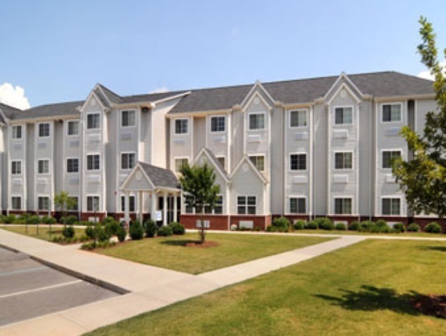

We did this 28,000 sq ft hotel done in less than a day…
…and yes, we Softwash with a pressure washer.
In all fairness, we did this spread out in three 4 hour days, but that was with setup and tear down each day too. We had to start at 10am and work till 2 PM, but we could have done it in less than one day if we could, but we had to work around the hotels schedule and also that’s working around customers too.
