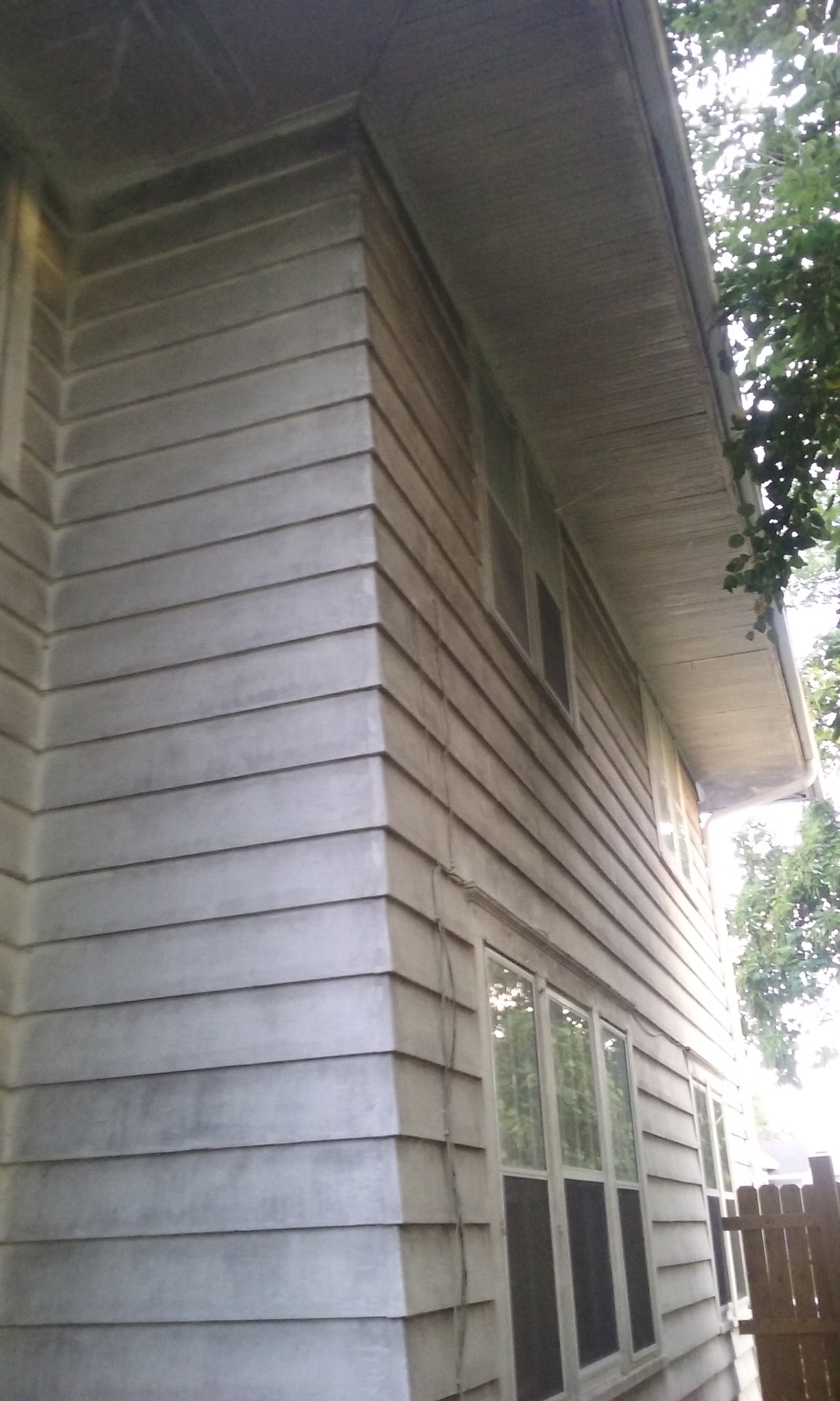

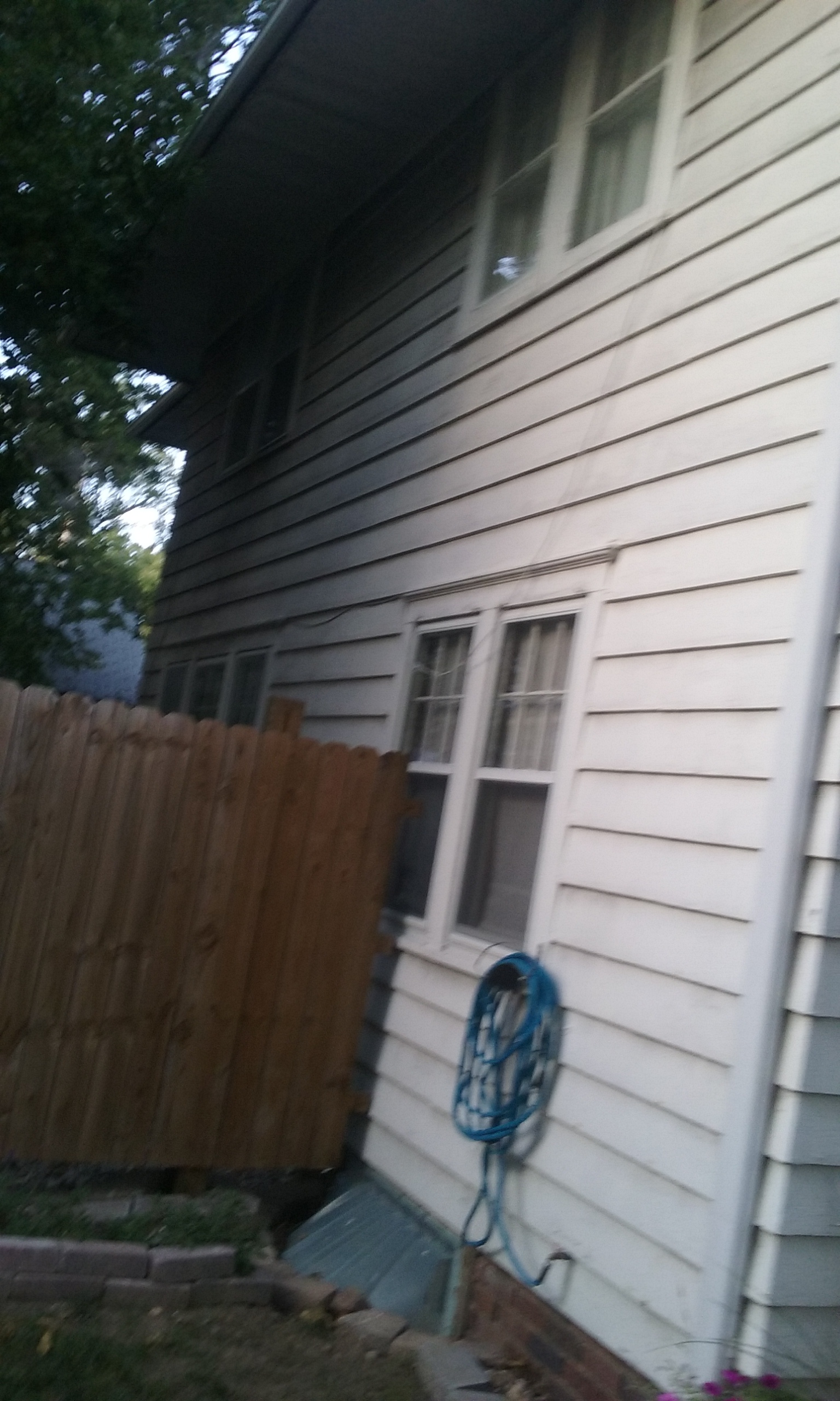

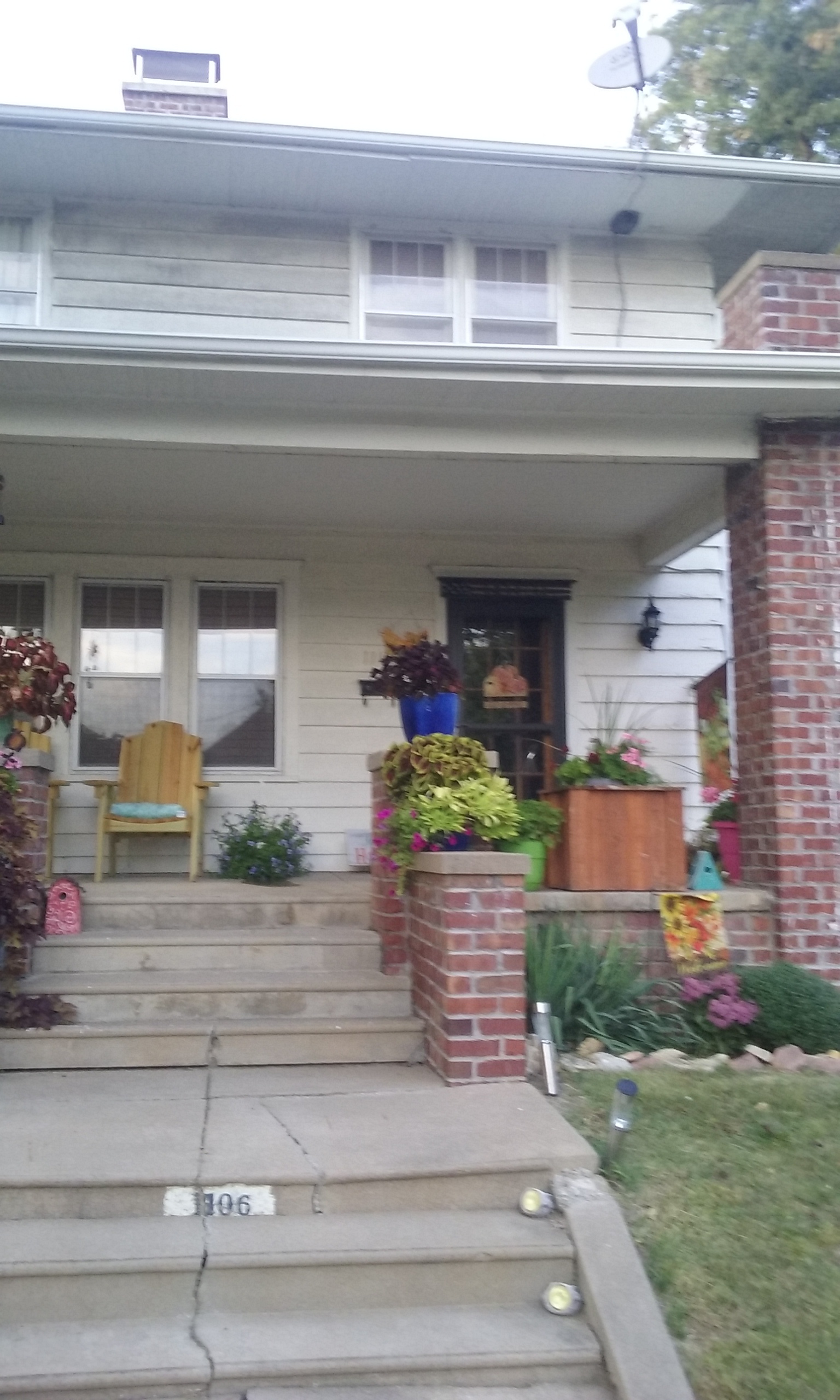

I have a customer wanting a quote on a 1500 sq ft 2 story home, dirty and moldy, I’m new to the business with no competition around me. I’m using a small pressure washer for now, trying to save up for bigger equipment. what would you all charge?

Can see the oxidation from a mile away
Its not my first job it is my first big job.
they are planning on repainting the siding.
That’s not a big job. Also that’s not something you should wash. I’d listen to @Patriotspwashing
Well then go ahead then. Call and order a case of Awesome, it definitely be ready for paint after that. Right @Grizz,@Racer
Its gotta get washed before they paint it right? not trying to question you guys just trying to understand.
Yes. Long as they know and you understand that most,if not all of that paint is gonna be on the ground and the lawn will be a white milky color. I definitely would get it in writing before I even unroll the hose. Most will say walk as would I, but its getting towards the end of season for yall house washers , So I get it. And don’t use awesome, I was joking
AC_SY400
This looks like a pretty small house. What makes this such a big job? What do you use for house wash? What type of siding is it? Have you spije with the painter? I have so many questions
Looks like a ton of soot on the siding, almost always that will require some scrubbing from my experience
ya i know its a small project for you guys, I have a 2500 psi, 2.5 gal. washer, its wood siding, I know i need a bigger washer. Dont know what chemicals to use.
Don’t walk, run away. Do as much research as possible for the rest of the year and save up some $ for proper equipment. Go back next year.
Why dont you talk to the painter. What do you use in your normal house wash
I appreciate your guys expertise!
Your issue is how you’re going to apply the chems. Thats less than a 2 hour job. 1-2% SH and a surfactant
