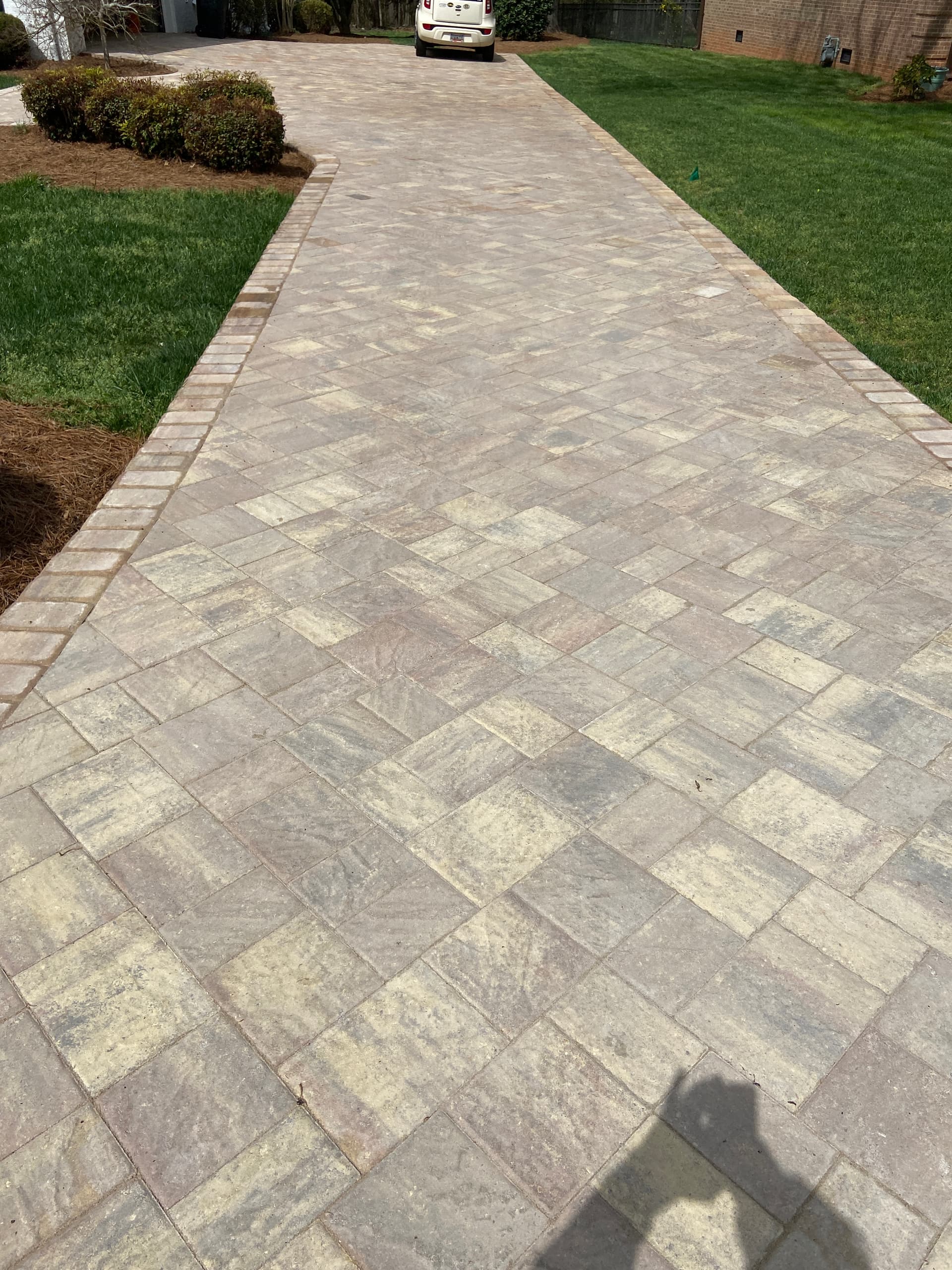

My first concrete sealing!
I’m super excited about this, 3300 sq/ft total of driveway and pavers. Water based on the driveway, 20% VOC on the pavers to hep the colors come out.
I really didn’t have to roll the drive much, but the patio did require some effort. I used my little 1gpm 12v, then a pump-up for edging.
He gets back tomorrow so hopefully it is what he was after.

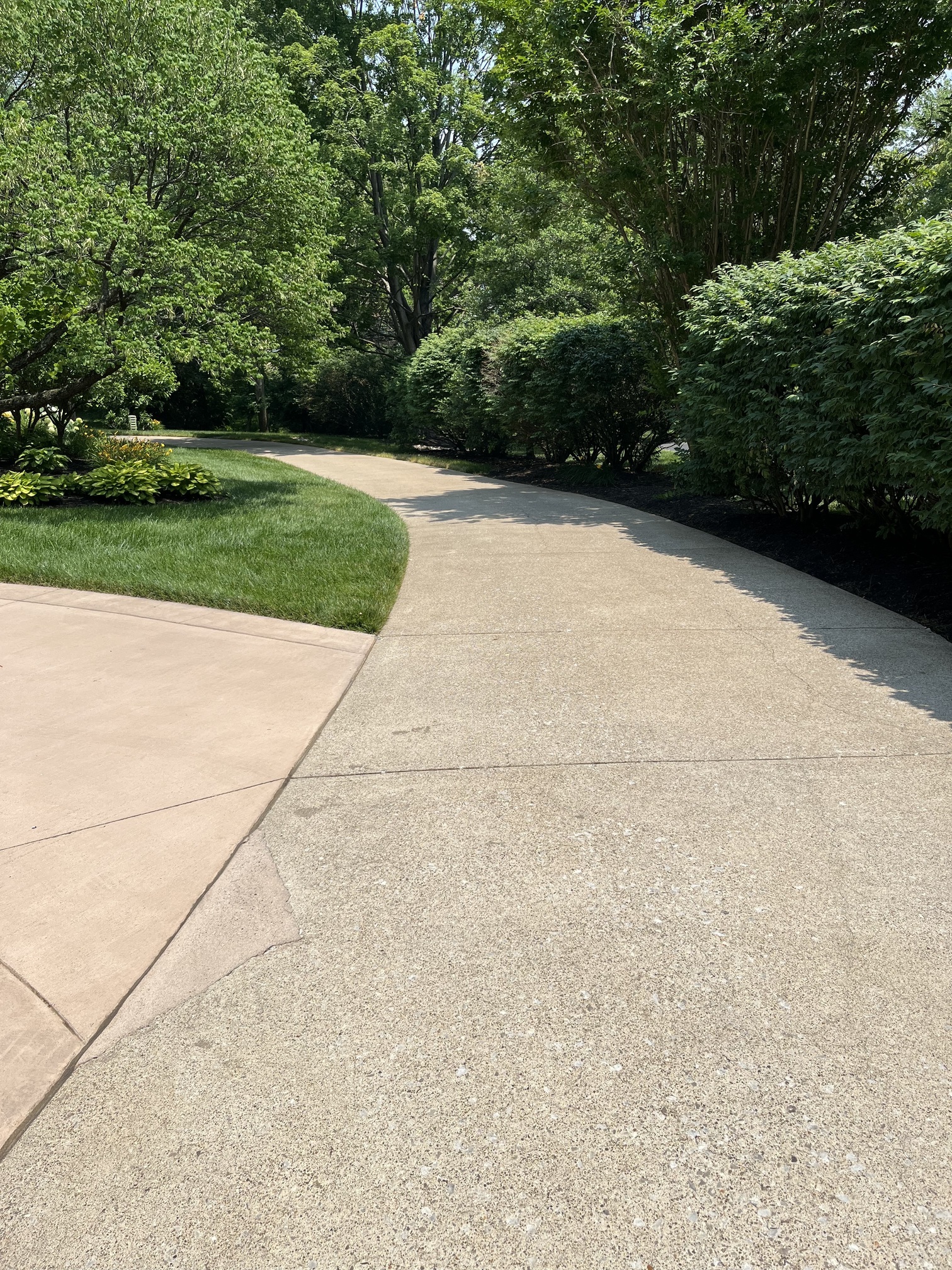

NIce! Had one pretty much like that lined up for today, but the weird weather made us rework the schedule…can’t wait to see how the aggregate comes out! Those premium services are a nice payday for you too!

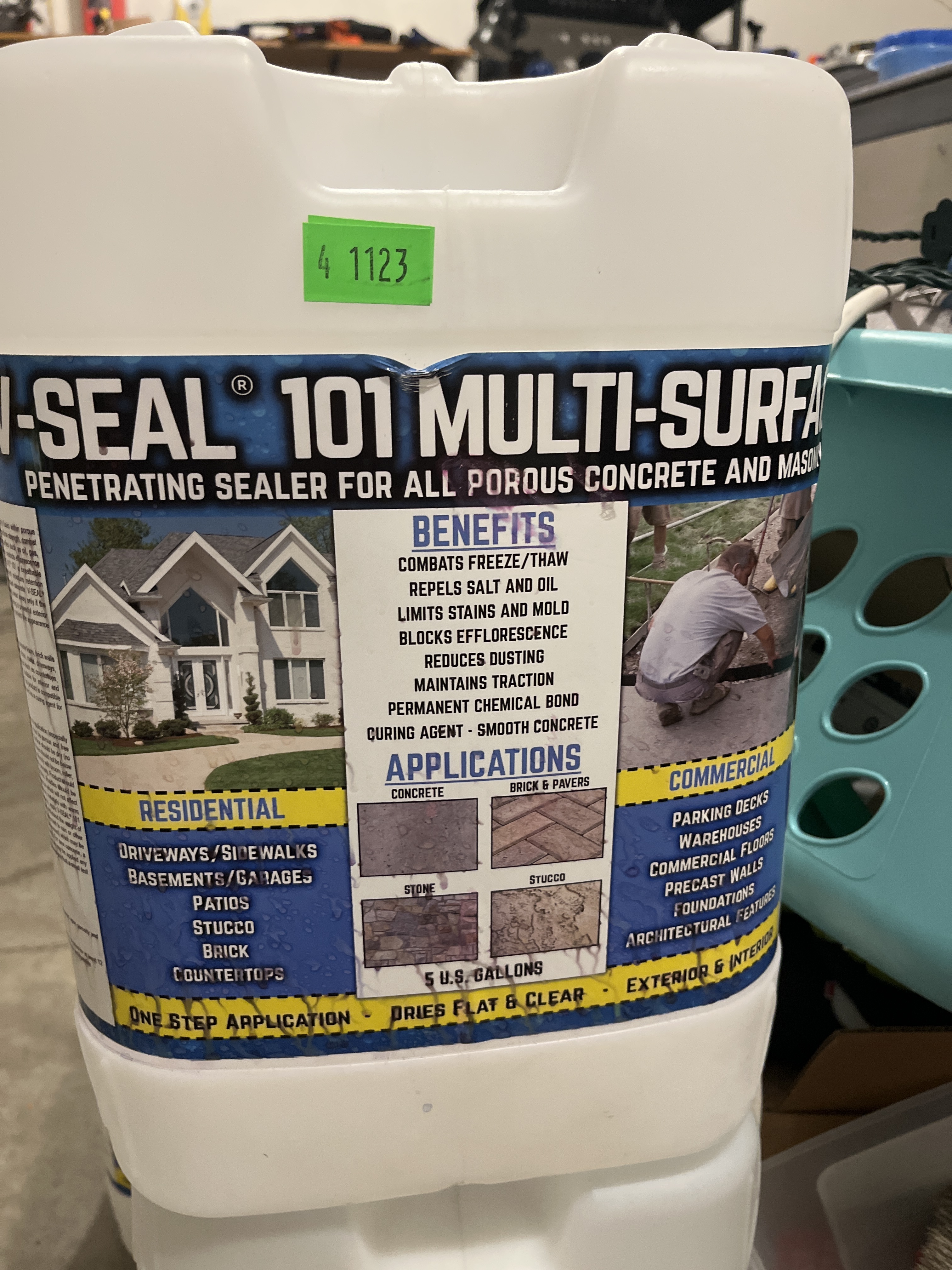

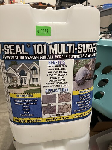

What sealer did you use?

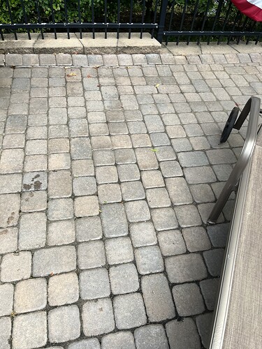

Do you have any afters of the pavers?
That is the after. Before was really bland and bleached out looking.
Got them from a local masonry supply company.

Got it. Was the sealer still wet when you took pic of pavers? Sometimes it’s whitish when you first apply.
Reason I’m asking is the pavers have what looks like a white haze to them. That usually comes from the using cheap sand that has concrete dust in it and they don’t clean off correctly. Not saying you did it, but whoever did originally may have. Hardscape contractors known for doing that. I would have insisted on acid cleaning those first prior to sealing. When you don’t you don’t get much color enhancement. I get called in a fair amount of time to fix that.

Here’s a sealing job I did last week. I was there staining the deck today. You can do this splash test within 1-2 hours after sealing it.
Wow Rick, amazing.
He did the previous sanding so I was just there to buzz it off and re-sand. I did blow and rinse the dust off thoroughly however.
