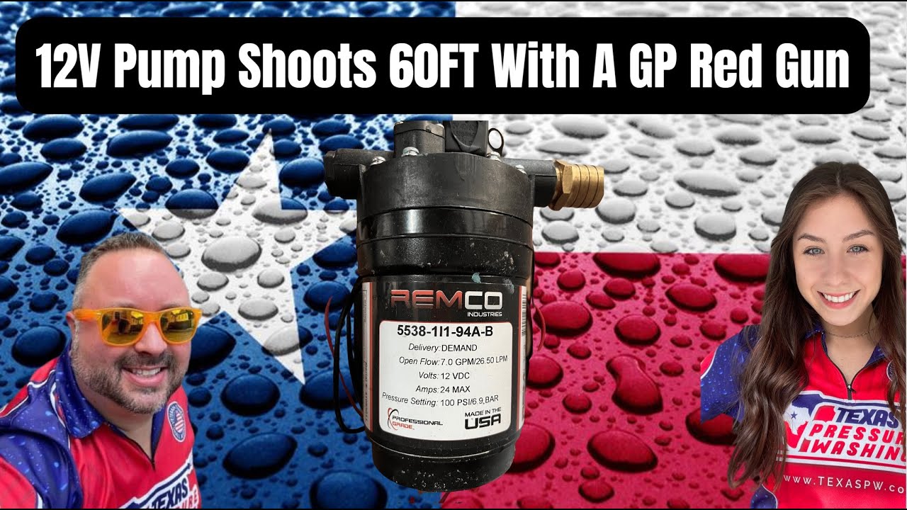

Changing your plumbing and metering valves to 3/4” and the soft wash hose to 5/8” will maximize your distance. We see 50ft on a single 5.5gpm or 7gpm 100PSI pump every time with that setup.
With two 7GPM pumps we see 62ft and an actual 6-7GPM flow. That was with a GP red gun.

That’s amazing. I have a Delavan 7gpm, 100 psi pump with a Proportioner (3/4” fittings) and 200’ of 5/8” hose and only get about 30-35’ of distance. (That’s until the darn stock relays blow out on the Delavan pump) Do you have two pumps working together to get those kind of distances? How long is your 5/8” hose ? I’d love to be able to get that distance!
We use 10 gauge wire for the pump.
5/8” hose is 200ft.
What size is your plumbing?
Yes we use two pumps together for the 62ft and 7gm.
