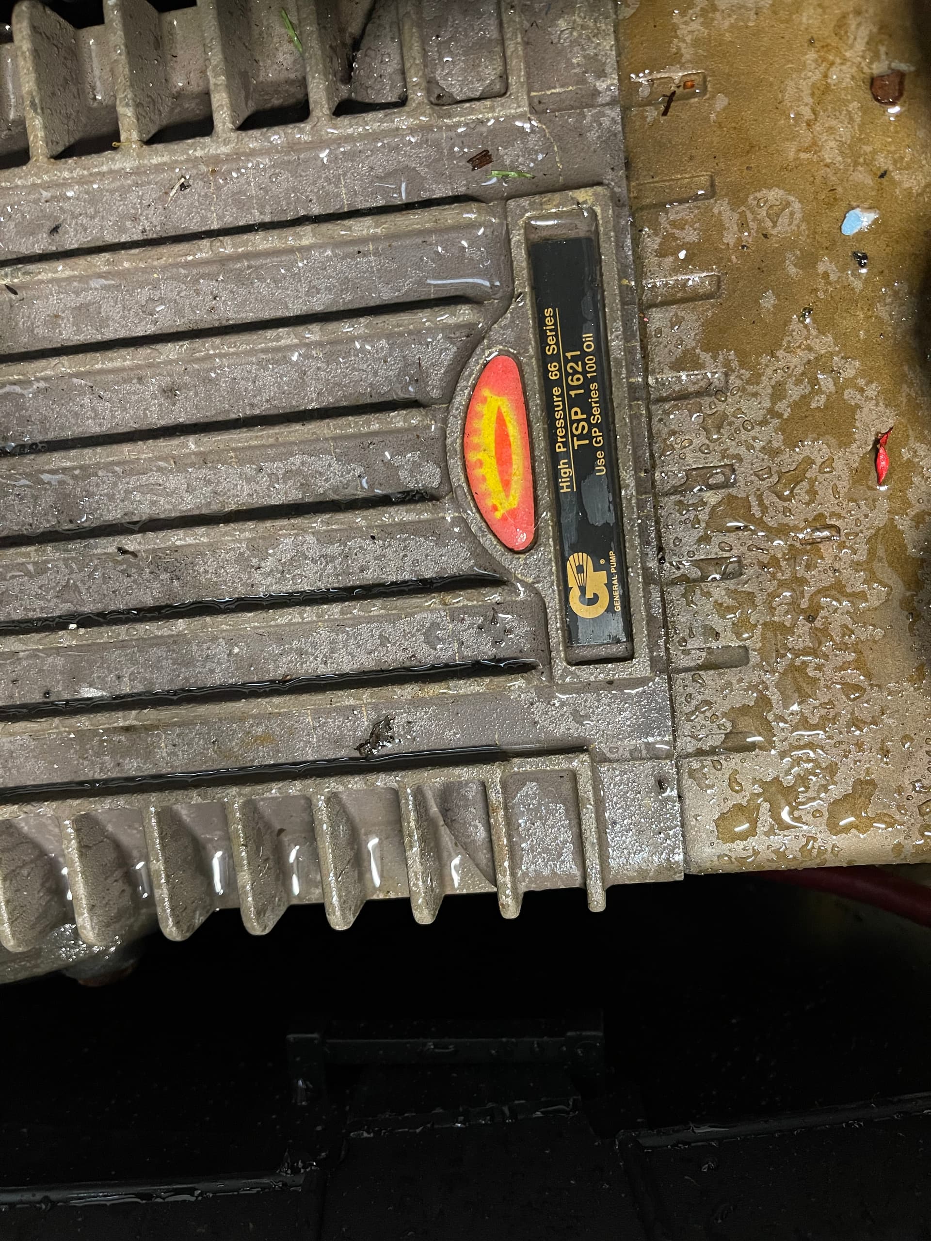

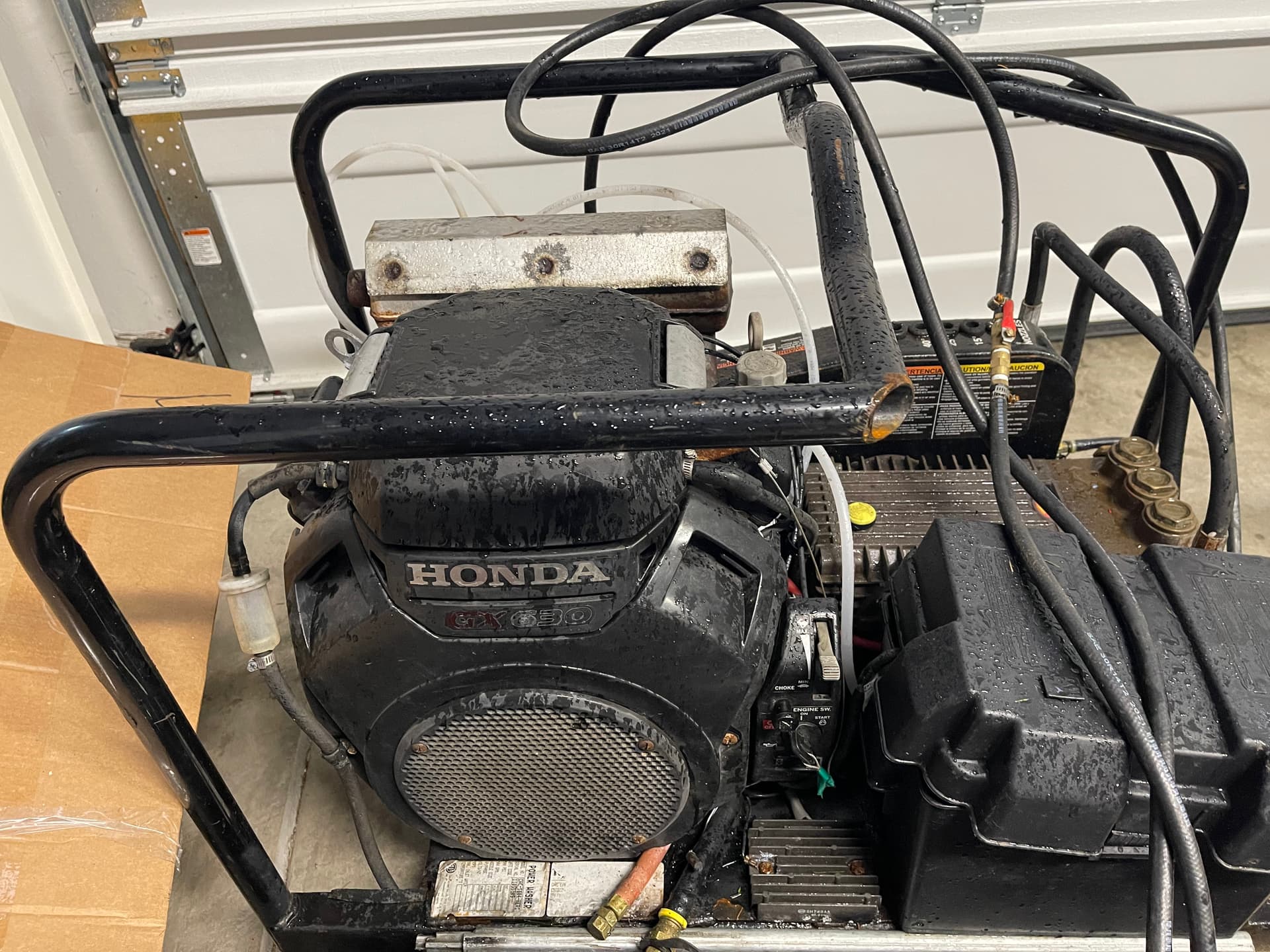

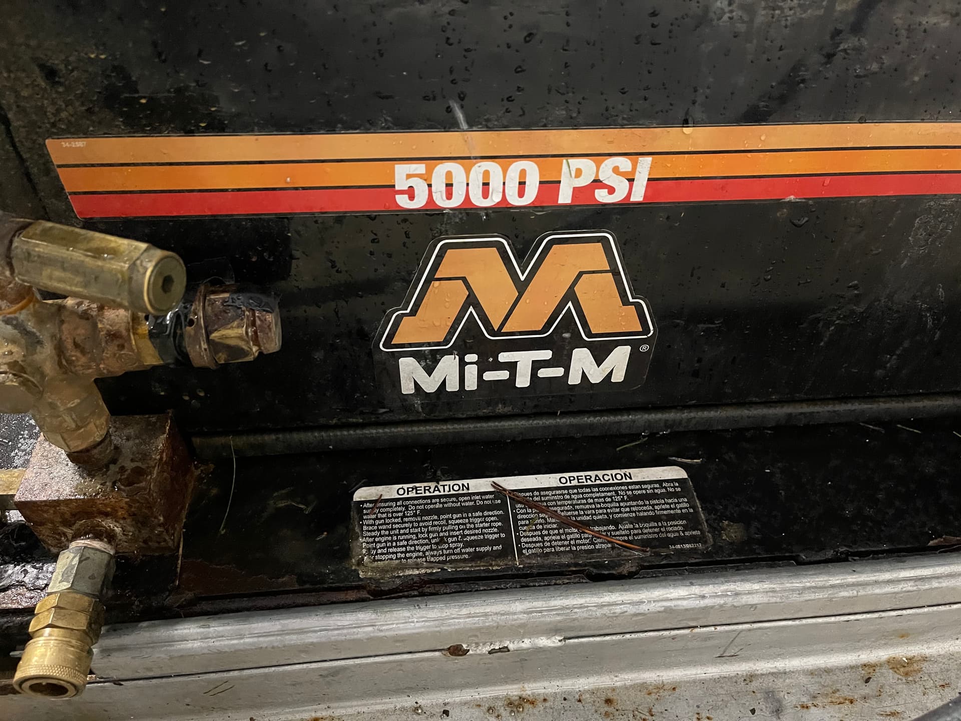

I picked a killer deal. It’s an overpriced MTM Honda GX630 with a General Pump TSP1621. It’s rated by the manufacturer at 4 GPM at 5000 PSI. I run 690s for mainly house washing so I’m familiar with these types of machines but never seen a 5000 psi pump used for what we do. Not sure if there is a use for this pump. My plan is to rebuild on a skid with a 5.5 GPM gear drive. This would be a backup support machine for our other rigs. I mainly bought this set up for the engine. Only 493 hrs. Runs great. Paid $600. Any thoughts on the pump or ideas of what you would do? I’ll update this thread as I build it.

Get bigger tips to lower the psi, we run our 5.5 gpm pumps for fleet washing on gx630 or 18hp vanguard . So you definitely can put a 5.5,6 gpm pump on there and achieve 3500 psi. I suggest the GP ts2021
My 630 originally was a 5.5/3500 machine, so ditto.
That’s definitely an idea
There’s a tsf2021 7.0 gpm 3600 psi that’s the one you are saying?
Yes, tsf2021 is an 8/3500 with a gx690 or 8/3000 with a GX630.
