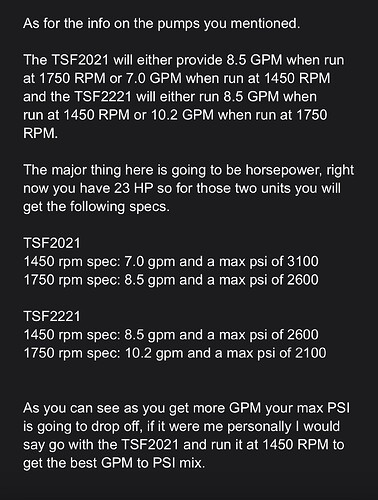

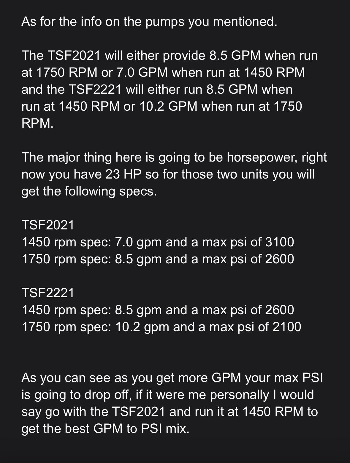

One more quick question then, do you get 8GPM/3000 psi out of the GX630? Maybe I’ll go that route and save myself some money. And then do the IGX800 for 10 GPM in the future.
Here is a conversation I had with a general pump
Rep last year when I was debating between a 10gpm or 8gpm pump. The ratings he gives was with a gx630 machine if that helps.
