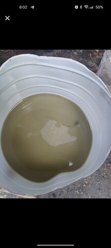

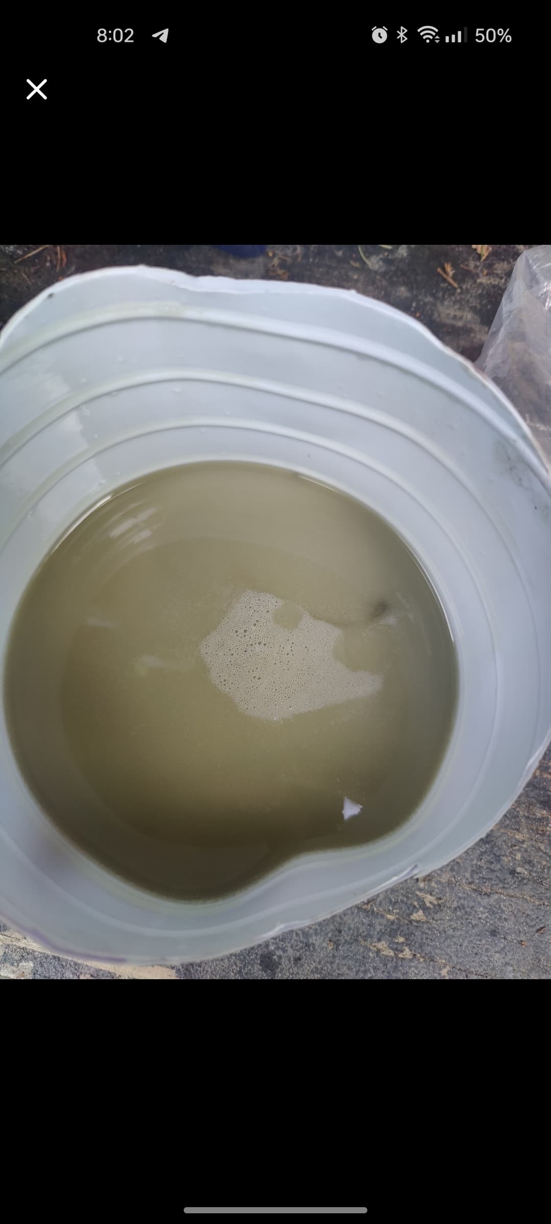

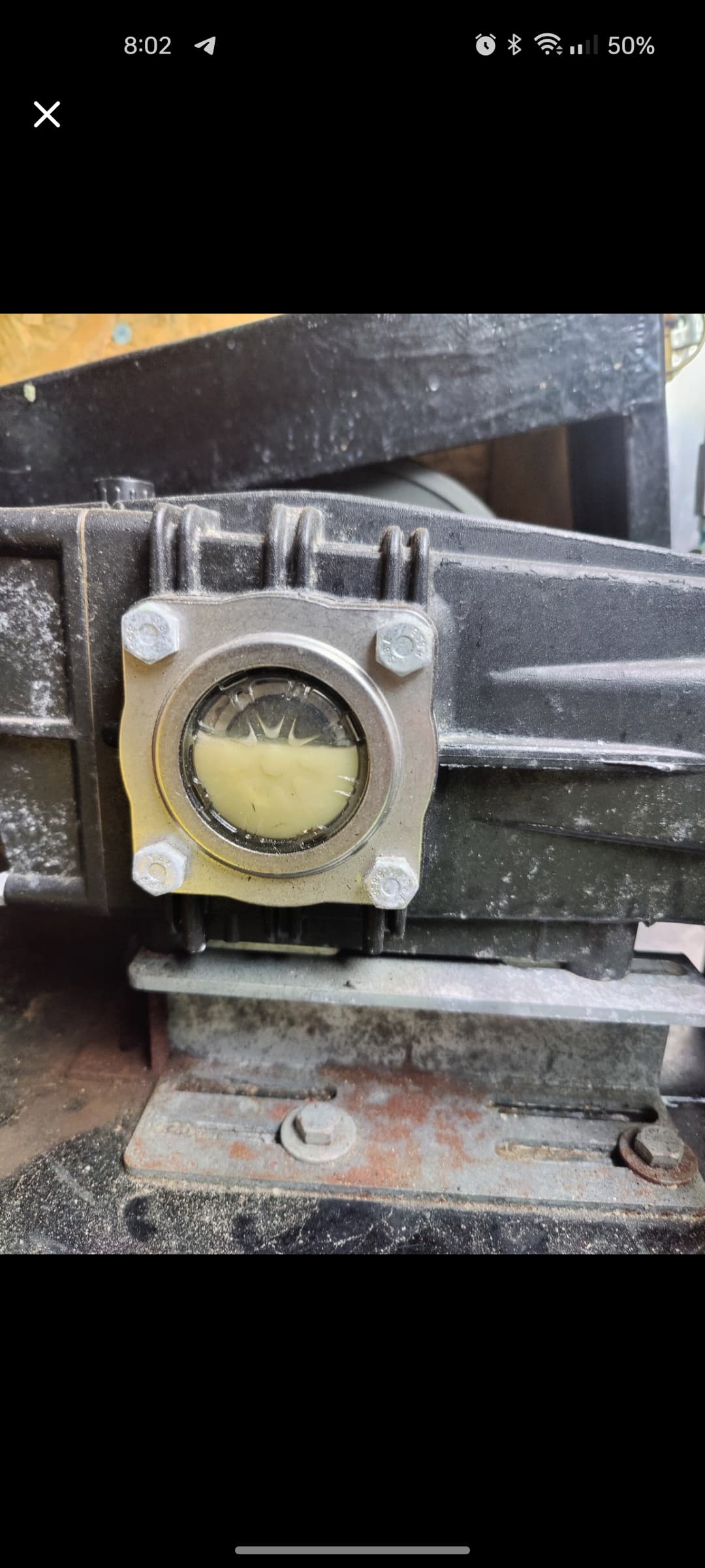

This is the state of my udor pump oil after 250 hours. Any advice to fix this. Is replacing the oil seals a diy project or should I bring it I to a professional.
Thanks for your advice.
Have not replaced my udors stuff yet but with my smaller units it was totally a doable DIY thing. Would call them up and see if they have parts or if it’s under warranty.
