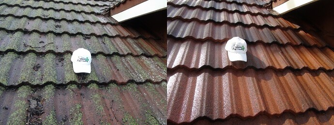

I did this job a few weeks ago and it went ok. I down streamed a light roof mix on the metal a couple times without letting it dry and then rinsed it off. It came clean but I couldn’t do anything about the fading.
